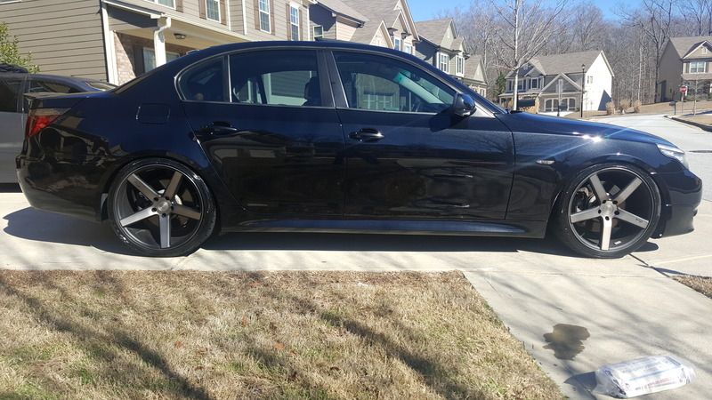

Default 06-07-2017, 11:26 AM
I wanted 19's but I had some 20's in my garage... so ordered some tires and figured I'd give them a try.... I think they look pretty good. They dont look too big... I have 245/35/20's all around...
