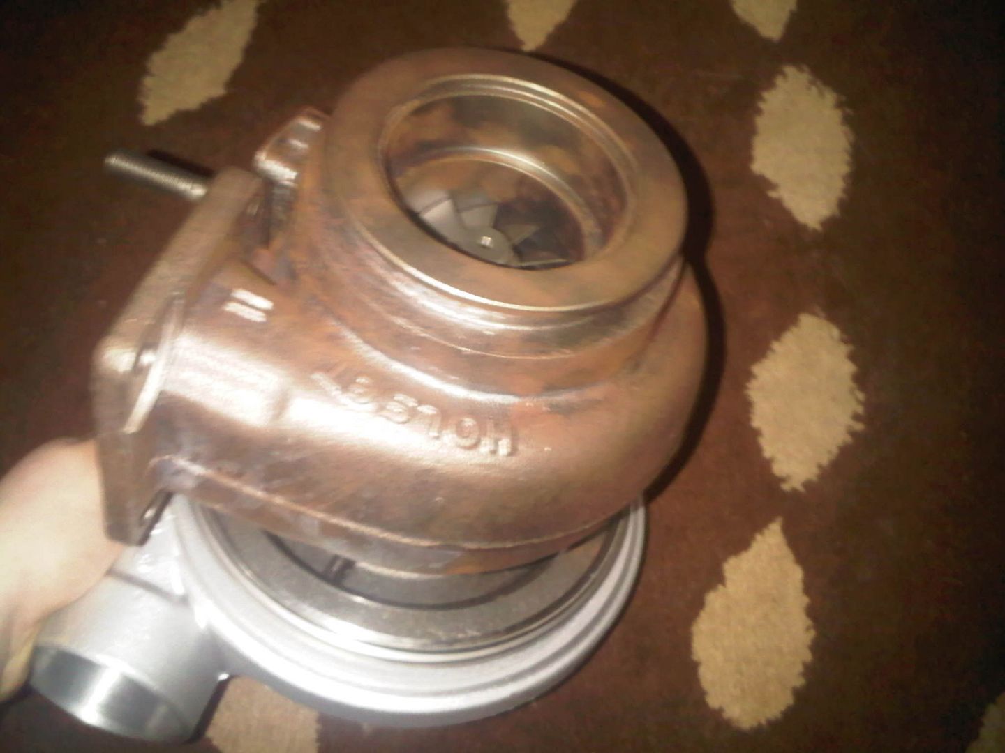

Im planning on going single turbo and ive had this turbo laying around from a different set up i was planning on doing. Its a hx52 might be to big but im more concerned with its fitment on the bottom as a bottom mount? can anyone chime in. Whats the biggest bottom mount put on a n54

If there's a will theres a way may have to modify the passenger fender well and definitely go top mount

Full spool by about 5500. This is not the turbo to use, but if you have it, and want to give it a shot, by all means. Holsets are not known for their spool up
