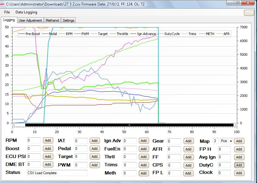

Just loaded it up. Felt very good and had a bit more kick then previous firmwares for me. Here's a quick 3rd gear map 3 log I took. Other than the fact that I think I have a boost leak, it looks good to me

Looks good from that log despite the fat boost leak. Will try it out tonight.
