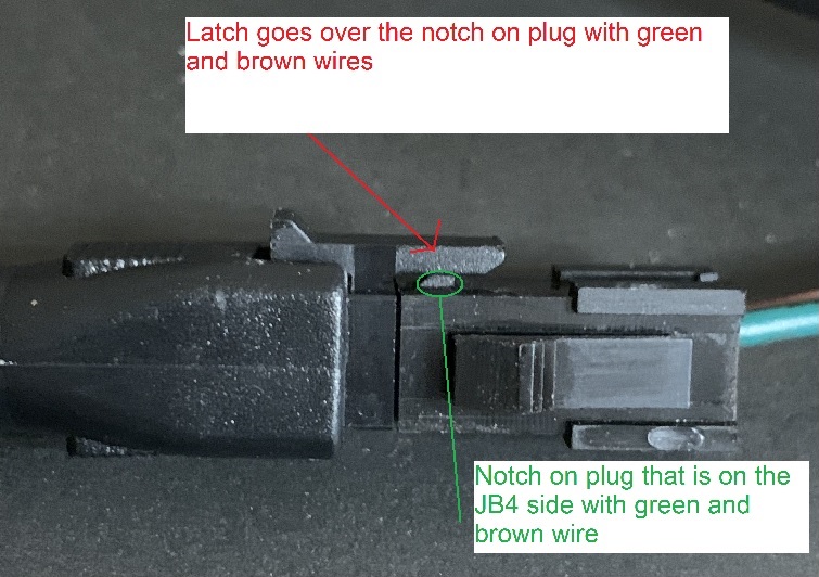

Hi george
Jb4 is now fully installed. The app shows firmware version 60/87 // 5 is this the alpha version? I still have the following problem. at Gauges it is only shown to me which map I am currently driving and the boost display moves. Nothing moves at Afr / RPM / Temp IAT
If I want to read out error codes, it says so too
https://scontent-muc2-1.xx.fbcdn.net...6b&oe=5FAA5195
Many Thanks

That is the one version before the Alpha.
Your OBD cable is most likely orientated in correctly on the small end. Use this picture as a guide to check it.

Hello George
The problem with the connector was done and now everything works. I went to work this morning with card 1 and it's already feeling really good. After work I tried Map 2 and the car was a little stronger. Unfortunately it rains all of us. But when it's dry I'll take a log at Map 1 and Map 2. I currently have Aral Ultimate 102 Roz in the tank. Did I understand the log to mean that I have to rev up in 3 gear from 2000 rpm to 6000 rpm and then slowly reduce the speed in 4 gear? How long is the adaptation drive until the JB4 has established itself with the ECU.
