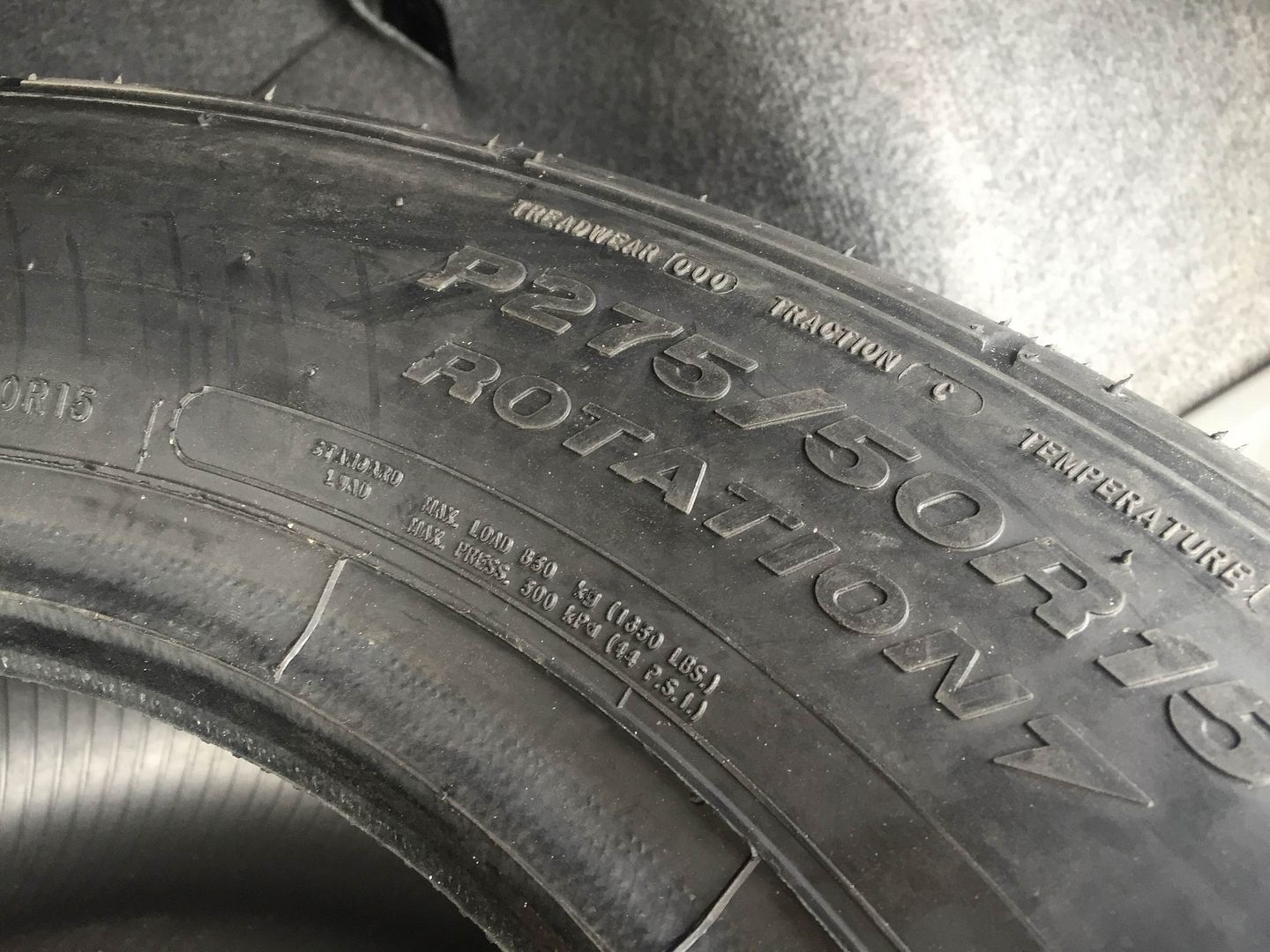

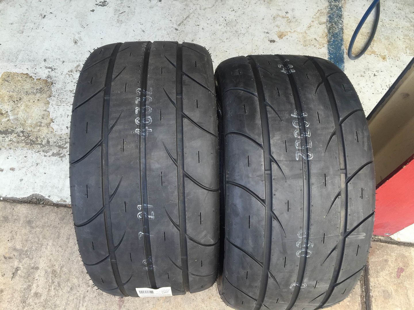

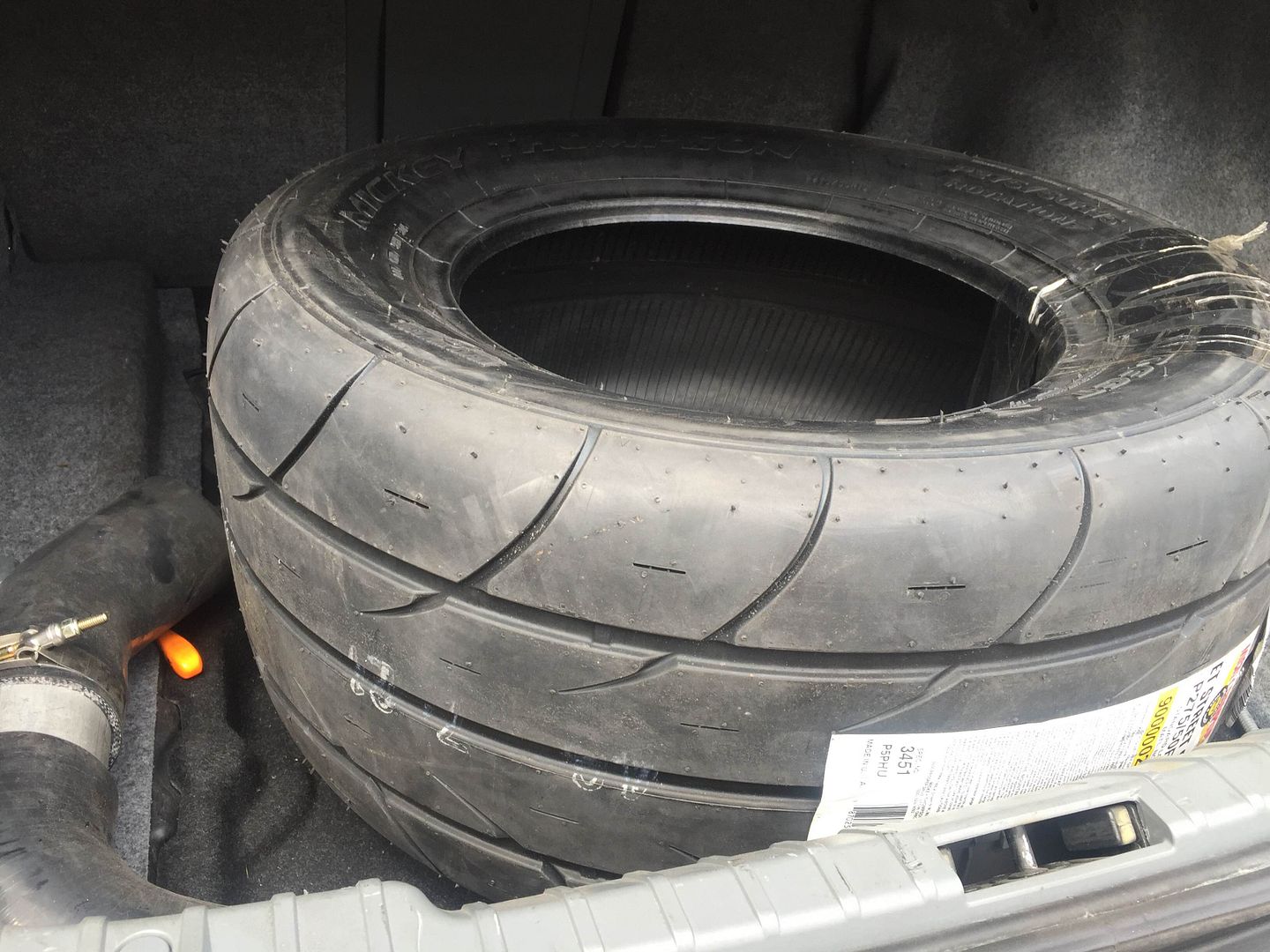

So after a surprising dyno last week, i decided it was time to start putting all that power to the ground. Anything over wastegate psi i spin all day, every gear....its fun, but sucks. anyways SO i have been collecting parts to make them fit and here is what i ended up with
15" weld' reps(reputable reps, yolo)
275/50/15 Mickey Thompson ET Streets
AD-E small brake kit
3:08 rear pumpkin(still running auto 3:46 diff)
Mfactory LSD
Diff brace
Tires are in and so are the wheels, just waiting on the other parts!

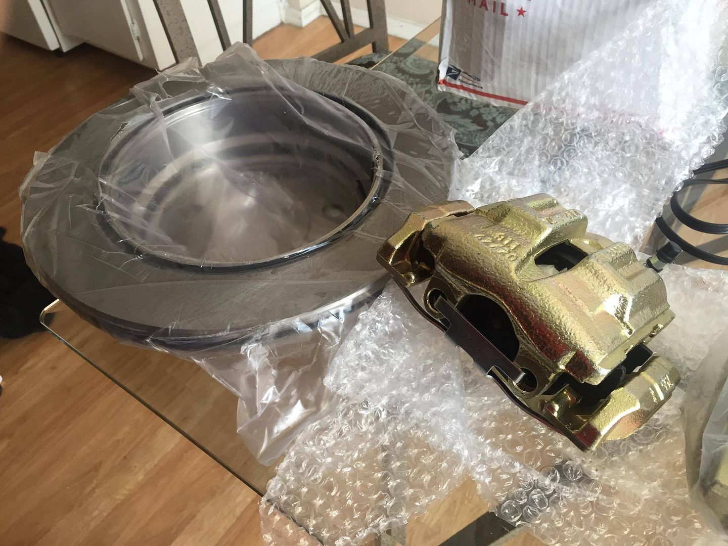

Brakes came in

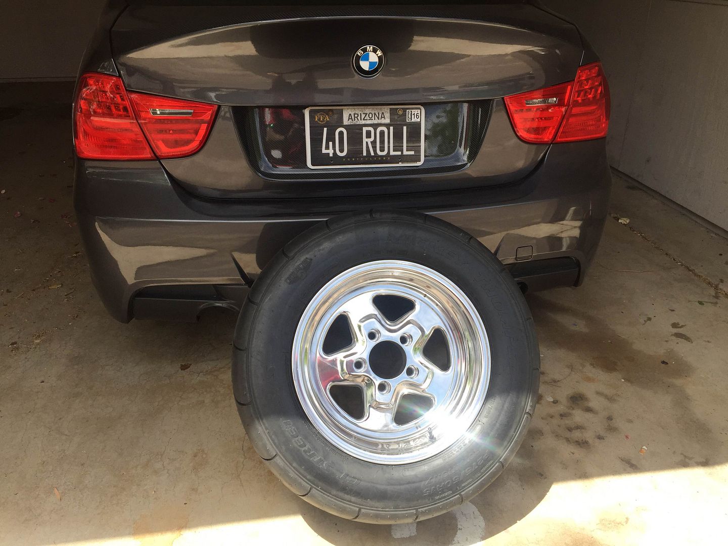

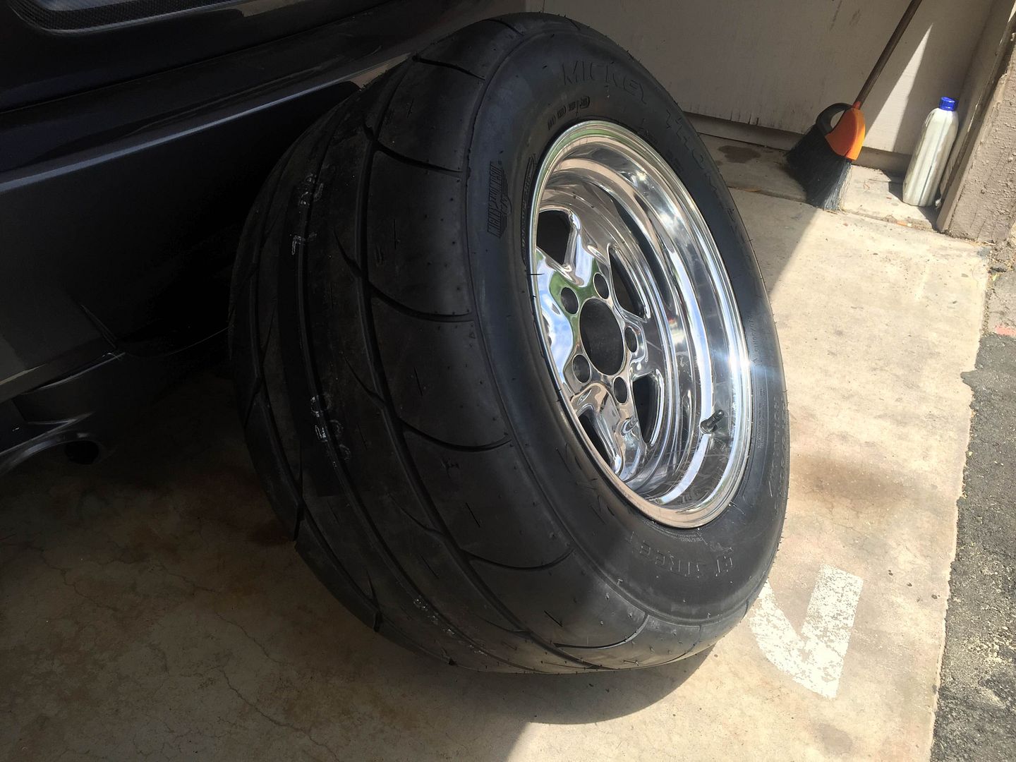

Wheels are 15x10 et 25 back spacing of 6.5" 5x4.75 bolt pattern which is essentially BMW 5x120

Please be careful with that bolt up. The Chevy pattern is 120.65

these 3 series use conical lugs correct? i think ill be ok

Right. I'm just urging you to take care. I've seen wheel offs in this scenario. So if you get some weird speed dependant vibration, please check them over.

Looks good! This is the setup I'm looking at. Just wanted to see someone else run them first.
Are those ET Streets or the ET Street Radials?
TS N54
omarmarji's Avatar
omarmarji omarmarji is offline
Posts: 915
Car: n54 335
Default 04-27-2016, 08:48 PM
et street radials

Can you please share the part number of the rotors?

im going to be honest, i know which parts are being used in this kit already BUT i spent too much for andy's kit to just spill out his info. sorry man
