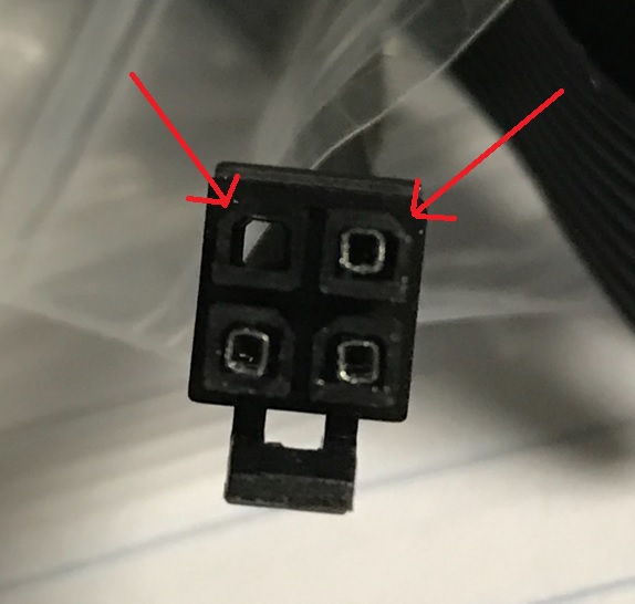

Did the gauges work before?
Do you have the OBD connected inside the car. If so check to see if the small molex plug is connected with the correct orientation. You can use the angles below to match male to female.
