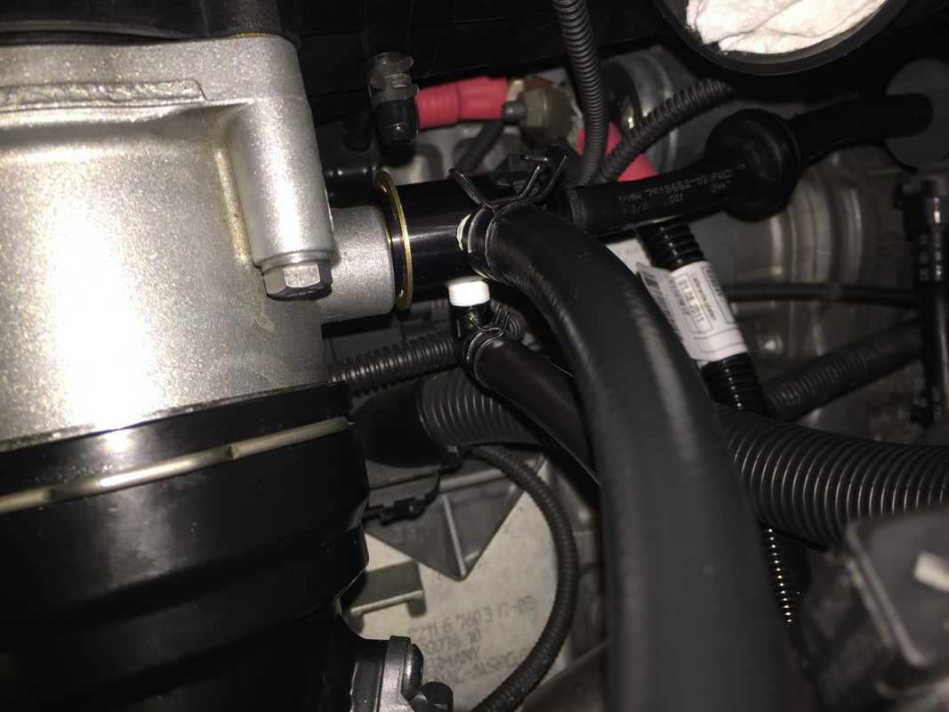

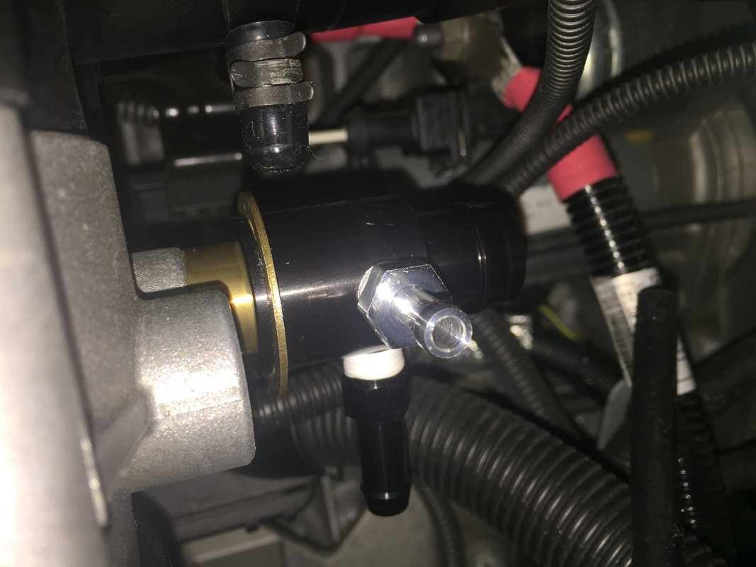

Hereís the adapter with two barbs: one for the BOV, and another for the RB external PCV install.

Super clean!!! Did everything else work out?

So far, so good. Just waiting for a 90 deg boot for the evap valve connector. I ended up swapping the orientation of the barbs and replaced the straight BMS BOV barb with a 90 degree one from Vibrant (bored out to 0.170”). Should provide nice short paths to the BOV and Mishimoto catch can.

Now that looks good!
