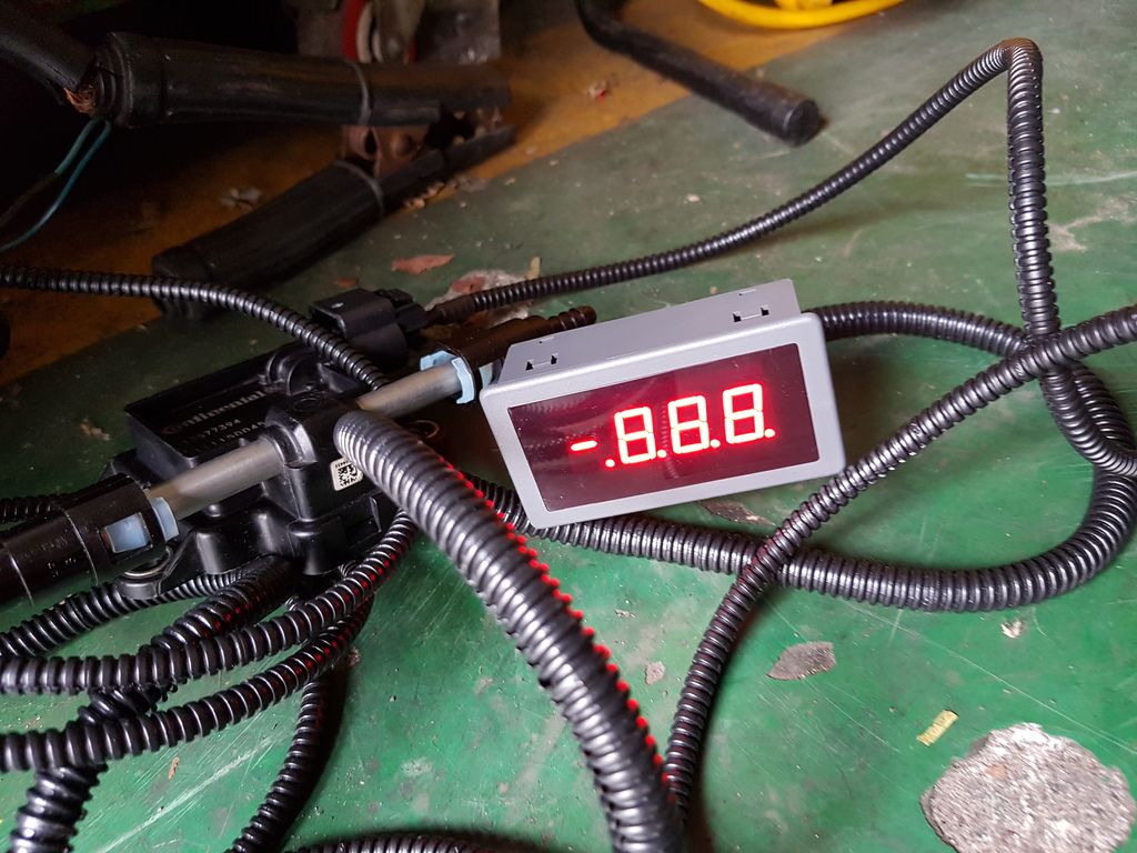

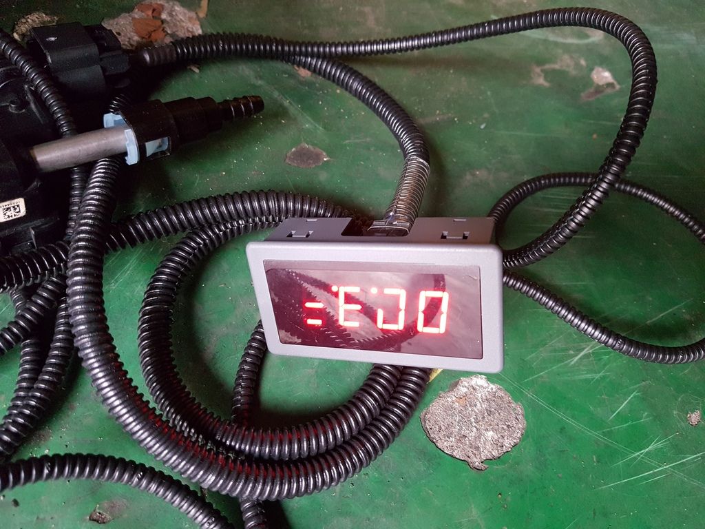

Default 11-06-2016, 04:11 AM
just got a item and test it.
The display showed like picture and after that unpluged the display wire , and re connected wire.
but the display show me another number like bottom picture.
after that,the display turned off byitself.
is that led display problem?
Make sure the sensor connector is seated all the way.
Make sure none of the pins in the JST connectors backed out when you plugged them together (seen it happen once or twice).
Make sure you have the display connector oriented the right way.
Try removing the 5ft display extension and run the LED right off the ECA connector.
Last, make sure all your grounds are good.
