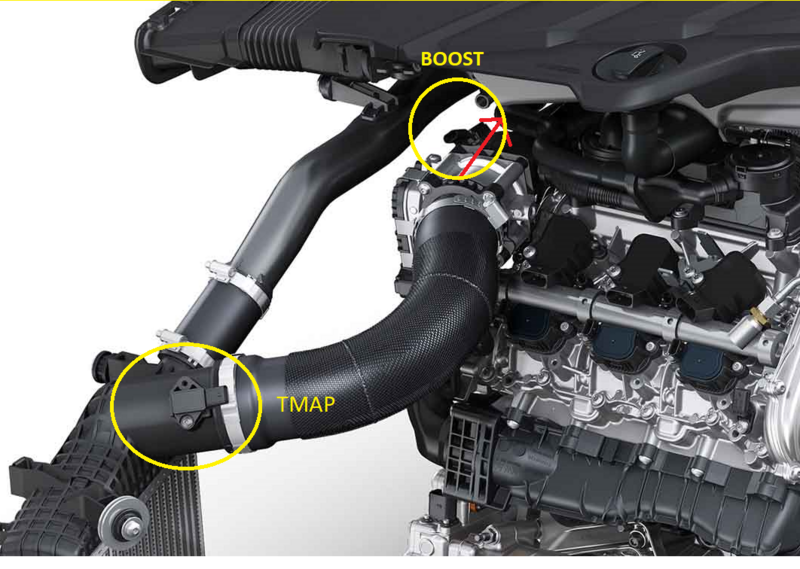

George, I own a 2019 Aidi Q8 which has the 3.0 litre mild hybrid engine with the Turbo sir and wanted to kindly ask you if the Group 7-JB4 Sent tuner will work on my vehicle and just wanted to verify before I make the purchase soon? The website shows that it will fit on the Q8 platform. Lastly, can you provide me with a link showing a video or a link with the installation instructions for installation on the Q8? I haven't been able to locate any myself<Thanks again,Respectfully,Lt.Robert Steele

The same guide that is on our site here can be used. https://www.n54tech.com/instructions...stallguide.pdf
On the Q8 the Boost sensor and TMAP connection differ. Some users could not get to the TMAP and had to go via the wheel lining although others had no issues.

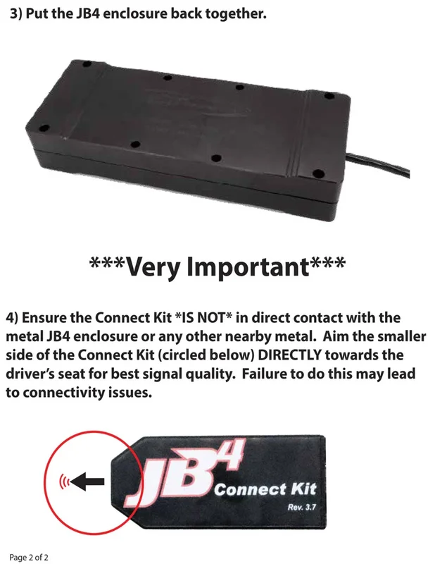

George, good morning and thanks so much for taking the time to respond and help me out on the installation and is there anything on the site which refers to the : Wireless Smart Phone Kit Installation as well sir? Have a great weekend!!! Much appreciated!!!

The phone kit installs directly to the circuit board. Below are the directions. Note the app is sold separately by the developer and is called JB4 Mobile.
