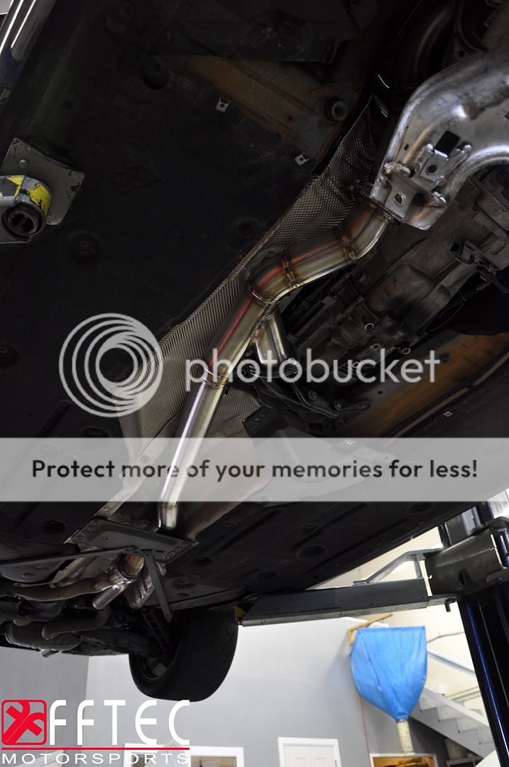

Exhaust was just made as well.

Awesome! That inline pump looks promising with a single turbo setup. Can't wait to install mine tomorrow. Getting ready for NFZ..
That exhaust looks sweet! No ***, just straight piped to stock mufflers.

this exhaust setup looks so clean ....
