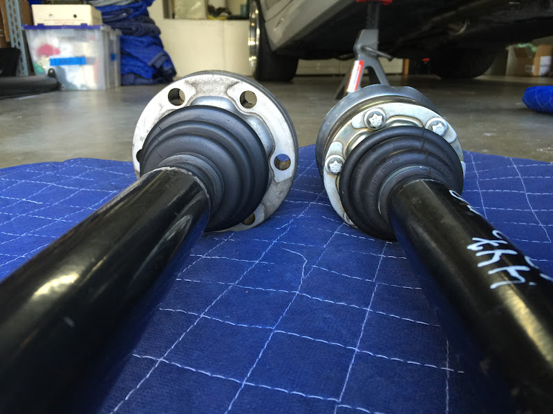

Spending some time on RealOEM seeing which parts need to be changed out to make my suspension M5-spec. Since the 535xi is already such a large vehicle most of the suspension is the same as the M5, only the front lower control arms, rear guide arms, and rear integral links differ.
Snagged these M5 arms off eBay. As it turns out the control arms are EXACTLY the same so I will keep them as backups if I have issues with my current ones.
The rear guide arms were slightly different:
LEFT: 535xi
RIGHT: M5
LEFT: 535xi
RIGHT: M5

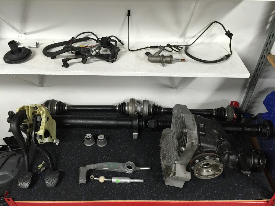

Speaking of M5 parts, here is a teaser of an upcoming project...

Default 02-10-2016, 09:10 PM
Trans arrived

For my manual conversion I sourced the pedal assembly from an E60 M5, the first unit I bought (with 2 pedals on the left) was damaged during shipping and the mounting location for the clutch return-spring was broken. The second pedal assembly I purchased (right) was supposed to be complete with clutch pedal and master cylinder but as you can see it was brake pedal and sensor only. Luckily between the 2 assemblies I was able to piece together a fully functional unit.
I am a big fan of machined pedals, I ran some on my old M5 and this will be my second set for the E61. I went with a brushed aluminum finish and it looks absolutely tits and should blend into to my interior well.

Here is the DIY for stuff like this: Bentley Manual and Google

Up next was comparing my 535xi driveshaft (top) to the M5 shaft (bottom). I was originally going to have the M5 shaft customized to mate with the N54 but I want to explore the possibility of configuring a hybrid driveshaft: front half 535i and rear M5. The downside of running a hybrid is the M5 6MT output flange, guibo, and bearing will all be smaller compared to a full M5 spec driveshaft setup. The upside it is would be a bolt-on solution and save some coin on custom fabrication costs. The difference in diameter between the non-M and M5 output shaft and guibo is under around 5% or less so rather insignificant big-picture. It is a long-shot but the M5 bearing may be compatible with the non-M front 1/2 of the driveshaft, once I get the halves separated I can confirm.
M5 knuckles dwarf the non-M
Notice the inner diameter of the bearing, pretty close! This is one reason why I think there may be chance to run a hybrid setup
Comparing bearing diameter
Here are some comparison pics of the non-M AT axles compared to M5
