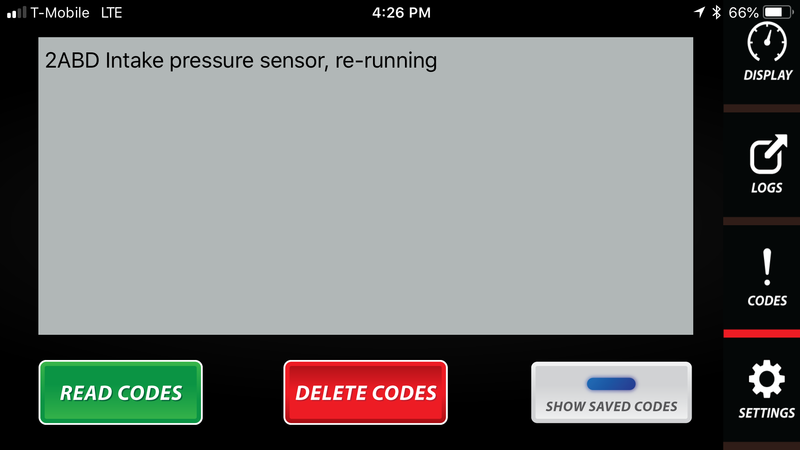

What codes is it throwing?
When I give it more than about half throttle the car will go full lean and not accelerate at all and it will throw all these codes. The boost gauge will read 0psi. This does not happen every time I go into boost but This has been happening more and more the past month. I’m at the point that I can only drive the car if I’m very easy on the throttle and I do not go into boost.

2ABD could be sensor related but that would be the only code. Seems like some sort of general electrical issue at work?
like what??? The battery is good. The car never has a problem starting. The alternator did die on me about 8,000 miles ago and i changed it with an autozone alternator. I did take the car to the dealer last year for the recall about the bad battery cable and new air bag.
I drove the car all day today about 100 miles and there are no issues as long as i drive the car easy and slow and not go into boost. Sigh... I'll wait for the new map sensor to come in and i just hope it will fix my problems.

Who knows, it's a BMW. They are world–renowned for being unnecessarily complicated. Maybe an engine ground strap? Shrug

I just got your new 4 bar map sensor last week and it 100% solved all my problems. No more codes. I can go 100% wide open throttle all day long and the car pulls hard again with no issues.
