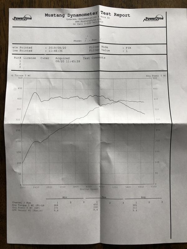

We have posted lots of European dynos with flywheel corrections. A user sent in some Mustang testing on his S4 running a E30 mix on map 6 with 7.5psi over stock. Car made 398whp and 435ft lb and they known to be stingy dynos. If you factor in the 15% most tuners are using its good for 460hp
