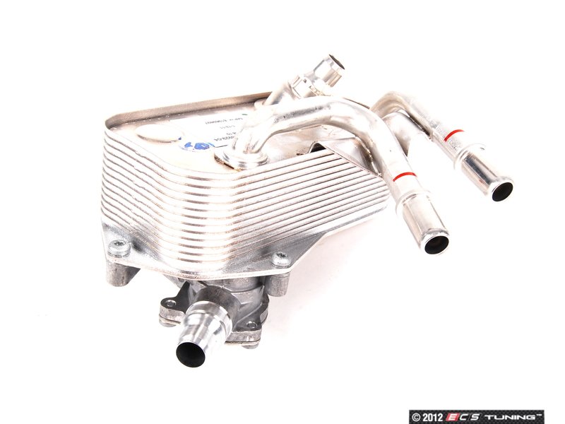

I've got a few questions for you with this configuration, firstly, is your car a dedicated track car?
1. What's the ideal operating temperature of the transmission?
2. Removal of the transmission heater will obviously lead to slower reaching of optimal operating temps, planning on timing this @ idle & cruising operation?
3. Did you consider installing the cooler inline/parallel to the heater?
4. The said Heater was thought to be a heat exchanger, is this not the case?
5. Pressure drops, how are you monitoring this (if any)?
Really interested in how you get on with this. Was looking into options with my DCT and there aren't any!

I can help with a couple of these questions.
1) Ive always heard 180 for ATF, but thats a simple change of tstat.
3) The bottom quarter of the radiator circulates ATF. You install the cooler in series to get additional cooling capacity and to not mix ~210 degree ATF with 165-180 degree ATF at the transmission. It also allows normal heat up of the transmission when you install a bypass tstat.
4) I still dont know what the heater block is or does exactly, but I do know that the ATF circulates through the radiator. As is typical with automatic cars.
5) I have this question as well, 16 rows is big for an ATF cooler.

1) Everything I've seen and researched across several AT platforms is that optimum operating temps are 160F - 170F so I chose the 165F tstat made by Improved Racing.
2) Yes but during testing, the AT fluid only took ~7 more minutes under idle to reach the 40C requirement for filling the trans with fluid with the new cooler inline compared to stock. However, it makes temp much faster under load.
3) No due to space and system complexity and it's not required because I'm not concerned with slightly higher viscosity for a little longer. Plus Red Line fluid has very good low operating temp performance.
4) The stock system is meant to heat the fluid up rapidly for emissions and efficiency purposes. Less viscosity = less friction = better emissions and efficiency. Again, I'm not concerned with any of this.
5) No pressure drops due to the type of tstat I'm using. It's a 90/10 so it's at least 10% open at all times.
I've been driving with this system in place for a few weeks now with no problems with cold shifting. Shifts are smooth and crisp and I really can't distinguish any shifting differences between cold and hot conditions. I've done several high speed pulls with no issues so far.

Actually, the only thing the ATF lines are connected to is the stock heater unit, which has been completely removed. ATF flows only into and out of this, as does the engine coolant. You can clearly see it in my first pic.
Please see my comments above regarding the ATF heater's intended function. BMW wants the ATF heated up as fast as possible and the best way to do that is tie it into a liquid to liquid heat exchanger via the radiator. The problem with this system is, your heat evacuation is directly tied to coolant temps, which can be in excess of 225F.
As far as the size of the cooler itself, you want the ability to dump as much heat as possible as fast as possible, especially when doing several high speed pulls consecutively. The fluid temp will always return to whatever tstat you have in line. Most turbo-diesel engines have ATF coolers almost the size of our radiators that keep the ATF cool under high load conditions. Same concept can be applied here. I'm just utilizing the space I have available to fit the biggest cooler I can.
This transmission has no problem building heat by itself alone. That's been extremely evident throughout my testing. I just wanted to completely separate my systems so that I can cool them independently so as to not suffer heat soak from other components. These Setrab coolers are incredibly efficient. I also installed one on the passengers side to replace the stock oil cooler and it performs extremely well. I'm using a 215F tstat for my engine oil and it hasn't gotten above 220 under consecutive high load high speed pulls.
Thanks mate! Did you mean to say road car?
So with this addition of a new oil cooler, as you say, there will no longer be any ATF lines into the radiator, and the heat exchange coolant return hard line is blocked off.
Which leads me to more questions, sorry!
1. Is air cooling or water cooling more efficient?
2. Would upgrading the radiator potentially also provide a decrease in ATF temps? And did you consider this?
3. If this new cooler is your own method of ATF cooling, would you not consider a larger unit?

I'll try to address the above questions/concerns...
1) Air to liquid is more efficient unless the fluid you're using to pull heat from a system is from a chiller. In this case the liquid you're exchanging heat with is engine coolant, which is far from being chilled and is directly tied to the engine temps. Engine coolant temps can easily exceed 225F for sustained periods of time and make it much more difficult to dump the heat from the trans, especially since there really is no cooling effect from the stock unit. It has a tstat in it that closes after the trans has reached the temp specified by BMW to rapid heating of the ATF fluid. After that, it closes and the trans is at the mercy of heat soak from the engine plus heat soak from fluid friction.
2) No ATF flows through the main radiator. Those quick-connects on the radiator itself are for the power steering fluid. The unit in the pic above is the only "radiator" that the ATF flows through.
3) The coolant supply and return hoses to the stock unit are both cut and plugged off. You can easily see the coolant supply hose in my first pic. The return hose is on the radiator itself and is cut and plugged the same way.
4) There are several ways of doing this. I wanted a clean interface with the stock AFT lines so I could run AN lines and fittings to the Setrab Cooler. Of course you can just cut the ends off and use barbed type hoses but I like to try and minimize potential leak points.

The stock ATF lines utilize quick-connect fittings (you can clearly see the male quick-connect ends on the stock heat exchanger in the pic provided by _ink in the above post) and I wanted to retain these and adapt them to AN fittings and hoses since the Setrab coolers utilize AN fittings. I'm plugging the coolant lines because they aren't needed anymore since I'm eliminating the stock ATF heat exchanger.
Originally Posted by R.G.
I like the project, kudos. If you are plugging the coolant hoses anyway why still use the quick connect fitting with the new added hoses? I'm not sure I'm understanding clearly. I could see needing the adapters if I were using the pre T'd off hoses from an IS and wanted to upgrade the secondary radiator. Regardless, I'm looking forward to seeing how this works.
