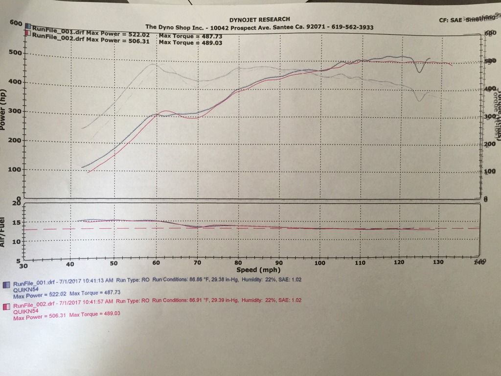

Hello everyone, I've had a chance to be a beta tester for Frankenturbos and want to share some results with everyone here. I am basically FBO, with MMP inlets, running a Fuel It Stage 2 lpfp, stock exhaust, and JB4 with BEF tuned by Trebila. I hit the dyno and am very pleased with the results. Theres still a little bit of tuning that Trebila is still doing to fix some fueling issues, I am running E30 and I wanted to get results in without port injection in case some enthusiasts have no plans for port injection and wanted to see what kind of power these turbos will make without it. I will be getting port injection soon and turning up the boost some more, as of now if I go any higher than 22psi on my car, my HPFP takes a dive and I misfire. Port Injection should fix this problem, but for now the car is pretty fast and traction becomes any issue, will invest in an LSD to fix that. Overall I am very please with these turbos. here is the log of the dyno pull
I wont be responding to any negative comments, thats not what I'm here for. I just want people to know that progress is being made. We are still in beta, and I have seen the revisions Doug has been doing to his turbos to make them better and reliable before their released.

Hello everyone, I've had a chance to be a beta tester for Frankenturbos and want to share some results with everyone here. I am basically FBO, running a Fuel It Stage 2 lpfp, stock exhaust, and JB4 with BEF tuned by Trebila. I hit the dyno and am very pleased with the results. Theres still a little bit of tuning that Trebila is still doing to fix some fueling issues, I am running E30 and I wanted to get results in without port injection in case some enthusiasts have no plans for port injection and wanted to see what kind of power these turbos will make without it. I will be getting port injection soon and turning up the boost some more, as of now if I go any higher than 22psi on my car, my HPFP takes a dive and I misfire. Port Injection should fix this problem, but for now the car is pretty fast and traction becomes any issue, will invest in an LSD to fix that. Overall I am very please with these turbos. here is the log of the dyno pull
Thanks for the info that things are progressing.
I'm interested to see your data logs. The numbers you provided are, not sure how to say this politely...unimpressive for an upgraded turbo. I pulled ~450hp/550lb/ft on a xdrive running e50 with stock turbos at 21 psi with a horrible tune. I was expecting that you would be making much more power with a protune and upgraded turbos.
I apologize in advance if this came off as offensive as that is not my intent. I want the turbos to be successful as much as anyone else. I'm just trying to understand why the numbers are so low.

Please post the .csv for the log! Also, are you using stock inlets? What is your specific part list?

Hi sorry I have mad edits to include the CSV file and MMP inlets to my original post. As for horsepower, I went as high as 24psi with these turbos but Ive has misfires from the HPFP not being able to keep up so i turned the boost down to 22 psi so that i dont run into misfire issues.
here are my mods
VRSF **
VRSF 7inch FMIC
BMS charge pipe, Tial BOV
DCI
MMP Inlets/ Stock outlets
Fuel it Stage 2 LPFP
JB4/ BEF flash by Trebila
If theres anything else anyone wants to know please feel free to ask

He is running E30. More fueling- > more ethanol -> more power.

Clearly all the time that was taken to develop these turbos has paid off. These are light years beyond the competition.
Read what you quoted from LazYME870... he ran out of fuel supply and needs PI or supplementary fueling. 550lb/ft wheel torque sounds high for stock turbos did they correct it for gear/diff ratio? If you really made that much torque the torque must fall flat on its feet up top if you're only making 450hp.
I think you need to go back and re-read what he said. He said he didn't want to put PI on yet because he wanted to get dyno numbers without these aids. He also stated that his HPFP is dying above 22pi. If you compare his dyno chart to others running e30-e50 at 22psi his dyno numbers are worse than what has been posted on stock turbos. There is another site that keeps up with dyno numbers, if you check there you will see what I mean.
