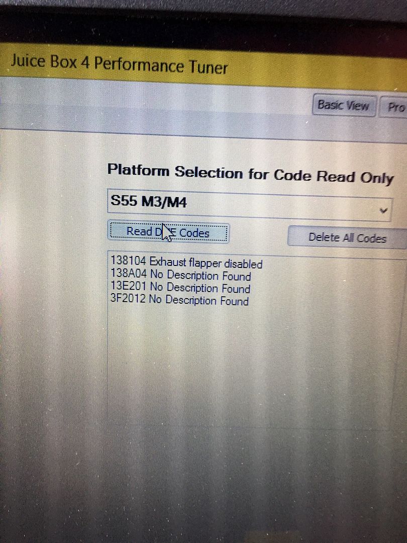

Default 10-25-2015, 08:15 AM
Looks like I may have a spun crank gear.... VANOS faults, long crank, rough idle, drivetrain malfunction indicator as soon as I turn on ignition... which started popping up about 200-300 miles ago while driving, with a slight rough idle. I would turn car off and it would be fine for a while then pop back up. As of Friday night, I can't get the drivetrain malfunction to stay off for more then a couple minutes after turning car off and clearing codes also the idle is very rough and cranks over about 1-2 seconds longer then usual.
As you can see I had suspicions of this as I was the last guy back on Sept.3rd asking questions on this thread.
Here is a picture of the codes that continue to pop up...
15' M4 : JB4 : BMS intake : Meisterhaft full exhaust : AR DP's : MSR Charge ***** : H&R Sport Springs / 08' E92 335i : Montego Blue : JB4-G5 : DCI : BMSMeth : BMSoilCC : VRSF DP's : VRSF Front Mount : 19" Vertini Magic : Bridgestone RE-11 : Carbon CSL Trunk Lip : MtechRearBumper : Mtech FrontBumper
The guy who had the same issue and had his replaced was also tuning his car.
To be honest with you, months ago when these cars were just hitting state side and people were picking them up, I had heard from my CA that this particular car was not handling the extra torque and power down low due to piggy back tunes and that not one but two of his clients had issues with the crankshaft and transmissions. Very similar symptoms if not identical but back then I didnt know about this issue. I bet now that it was the same issue. Whatever part bmw is using just can and will fail for some owners.
Long story short, I am certain that whatever the rod bearing was for E9X, this issue will be the same for this platform. And if I were an F8X owner and I was until a year ago, I wouldnt tune the car knowing this issue. Way, way, way too involved of a repair reading that thread in bimmerpost. That guy got very lucky taking off his down ***** and JB4, you or the next guy may not be.
S63TU has its own share of problems with tuning and component wear. Not as bad, but still. Spark plugs and injectors to name a few. You gotta pay to play or just not tune. I honestly dont know what everyone does with all that power.) These cars are so powerful in stock form, most of this tuning is for bragging rights
