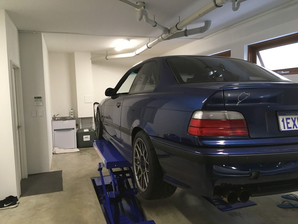

I don't have a ton of garage space and low ceiling so I'm getting one of these
http://www.aaq.net.au/shop/detail/autolift-al-3000bg/
Mounts flush with the floor when installed.
This is where it's going.

Default 01-19-2016, 07:51 PM
Installation is easy as it just sits in the trenches.
Getting it off the truck and in the garage is the hard part as it weighs around 1000kgs.

Default 04-02-2017, 07:59 PM
Now looks like this

Mine was formed as part of the slab.
I can see how that could be an issue if you are retrofitting.
