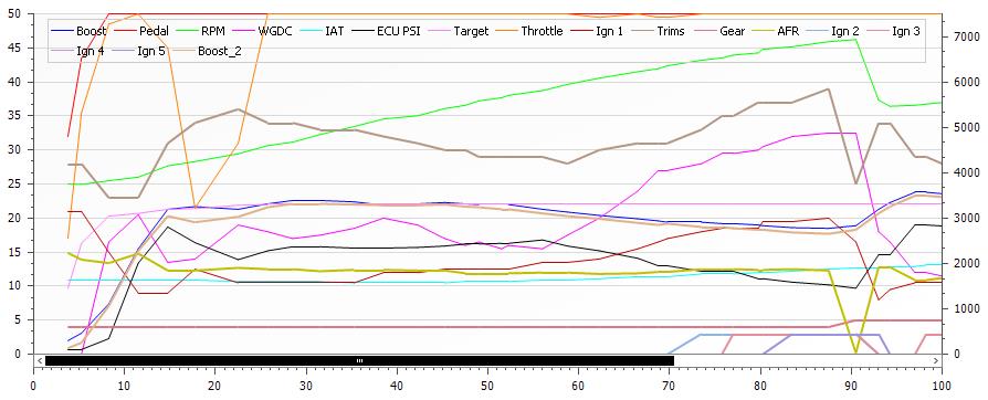

Out of interest here is a log on my stock RS3 in map 6. Its just short of 23 psi. Will jack the map up a bit over the next few days and see if there is any value in running higher than that in the midrange.

Default 02-06-2019, 07:16 PM
IAT look pretty high. I assume a better intercooler will help with timing pull?
Is this with E30?
2018 Audi RS3

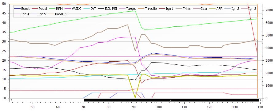

2007 Acura TSX
(#139)

Same run going into 5th. Its on 93 with some octane booster.
IAT keep climbing so cooler will be a major benefit, I reckon its should be first mod hardware wise. There is slight timing adaption but not a issue as the average timing is still high.

Going back to the 4th gear part of the log, Did the throttle close for a moment?
Yes, on boost onset. ECU will do this to assist with boost control.

Correct. In order to keep the chart compact in terms of scaling you x10 for temp in F.
Is there a post/discussion somewhere on how to read and interpret the log chart. I have a basic understanding but would be keen to learn more.
Iím assuming you can select / isolate some of the graph data to make it easier to read, looking at it on my iPad it can be hard to discern some of the colours.
I had a hard time with some of the colors but got used to them after a while. I'm used to viewing datalogs but this thread helped me a bit:
Logging Parameters and their Meaning - N54Tech.com - International Turbo Racing Discussion
