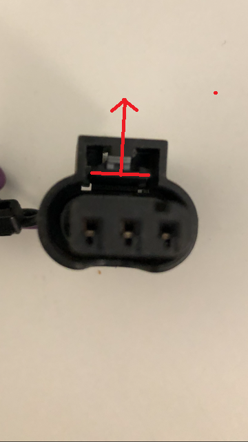

Can you be any more specific? I used a screwdriver to compress the front of the clip, but I couldn’t get it to budge.
I used my finger to compress the front and the screw driver at the base to pop it off. Hopefully that is the key.

Did you get the fuel pressure plug off? Any tips? I could not get it off after 30 minutes. Otherwise easy install, updates firmware ready to rock!
It's sort of a PITA as it's hard to get down there, I used a screwdriver on the bottom of the clip to lift it off the tab so you can pull it up. Experiment with the TMAP connectors plugging in to each other so you can see how the clip works at the bottom.

I got it. Just took a bit more torque than expected.

This diagram will help. The small flap needs to be lifted slightly for it to unclip.

Small flat head or an L shaped hose pick to get under the flap after you undo the grey tab.

For those connectors, once you pull the lock up (that grey part), you can then squeeze the lock back onto the body which releases those two little tabs inside.
Fuel pressure one is a different style of connector than the rest. You pull the lock clip up, and then there is a little black "button" that is released. Same sort of deal, squeeze and pull. Like George mentioned, you may need to stick a screwdriver between the base of the sensor and the connector, turn it slightly, and it will release. If it's not letting go, then that little black button isn't pressed so it's locked into place.
