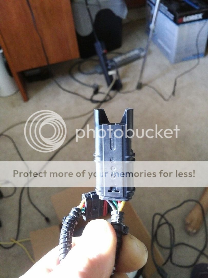

Hi Terry. Do you have the part number of the male end of that connector? was about to install in my N55 F series and noticed the male end on rainbow connector of JB4 had broken retention tab.... would like to just replace shell and swap 4 pins to new end.... can u guys sell me the male end?
