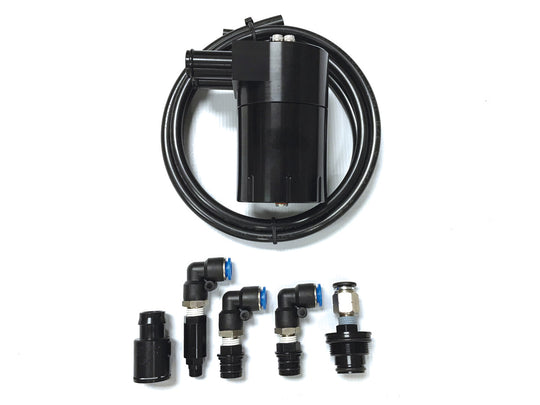

Have the final kits ready to go!
Install photos of the final kit with quick connect fittings will be posted Monday!

Whats the difference between having this setup compared to the RB external PCV kit?
Posts: 29,695
Default 04-16-2019, 01:25 PM
I'm not as familiar with what RB offers these days but I believe they offer a similar vacuum side OCC kit.

This looks like fittings are made to use your high side can, are the nipples sold separately, I already have your bov kit and can.
Posts: 29,695
Default 04-16-2019, 02:12 PM
For now only as a full unit, you'll need 2x cans anyway. One for boost side one for vacuum side.

Btw, is this 3/8 for the pvc side?
Posts: 29,695
Default 04-16-2019, 02:22 PM
Yes we went with 3/8.

Hi Terry,
Please Explain the purpose/use of it.

Where does the outlet lead? Does it recirculate to the intake through the BOV? I have the Phoenix intake and integrated PI so I have a reference line to the BOV from that...

On The low side,one side goes to throttle body adapter and the other side goes to back of valve cover correct?is there a checkvalve also for I dont see one.

Internally, is the can the same as your boost side one or does it include a filter like the Mishimoto version?

Trying to answer all the questions the best I can:
Full dual baffle system inside of each OCC.
There is a check valve inline of the fittings we provide.
There are two ports on the valve cover.
One port goes to BMS OCC to the intake.
Second port goes to BMS OCC to BOV/Throttle body adapter.

Originally Posted by K.Jameel
Hi Terry,
Runs vacuum side PCV through an air/oil separator to keep oil off the valves when under vacuum. Complements the boost side OCC which does the same thing under boost. With this design you do not need to cap the ports under the valve cover although you always can if you want, because our fitting disables them, and replaces them with a vacuum source on the manifold.
Posts: 29,695
Default 04-17-2019, 01:46 PM
The check valve is built in to the PCV fitting.
