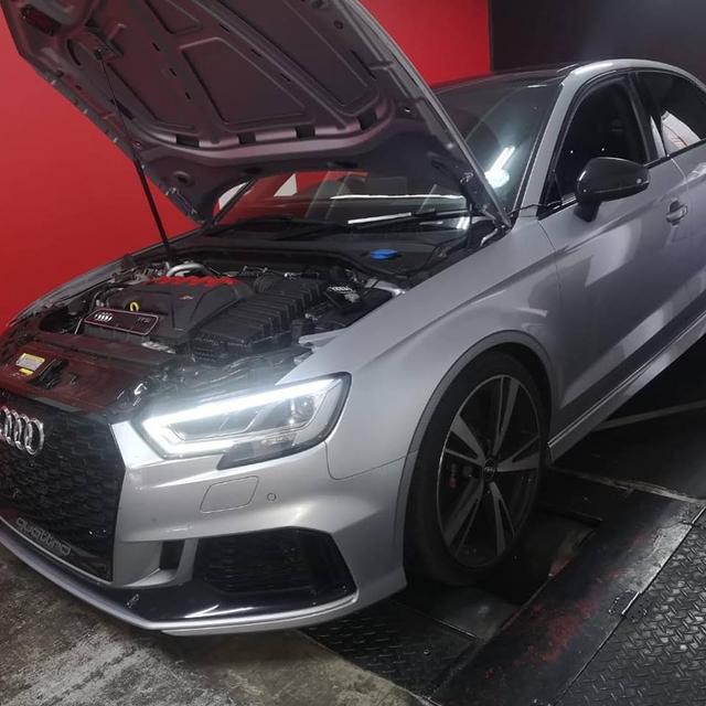

Posts: 960
Default 03-30-2019, 05:02 AM
Some great numbers on this JB4 Audi RS3 running a E30 fuel mix and no hardware mods. Gains of 67whp and 115nm/85ft lb. Map 6 was used with a 6psi peak add.
