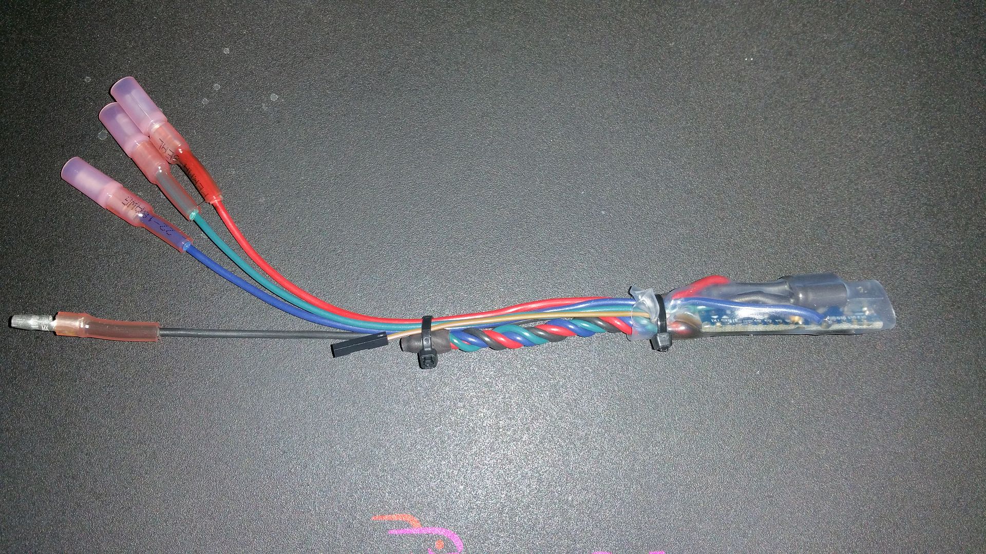

First digital display shipping out. Ended up using RJ45 connectors for the connection.
Future ones will have a female connector on the ECA side instead of male (doesn't make a difference, just eliminates the cost of the coupler).

So I finally got my sensor installed. I used the genuine GM part #3577394 sensor. I used Dorman fuel adapters #800-085 and spliced them into the OEM fuel line.
There is something wrong cause it is not working. My JB4 mobile app shows my E content is 87. Hooked green wire to pin 15. The Str8shot eca beta app, does not work at all. It will not connect and keeps asking if the device is turned on. Never asked me to pair or enter code 1234 like you stated earlier. Is this the right app, cause it only shows there have been 5 downloads? It also does not support landscape mode. It is the only thing that came up in google store search.
The device itself shows a solid green light on one side and a constant blinking red light on the other side.
Right now I should have around E30 in my tank. There is no way I have E87.
I must have a bad Analyzer? Wiring is pretty simple, I double checked everything. Power supply: Red positive to same place as JB4 , Black I crimped a ring and ran to ground bolt: then used y-cables off power supply (red and black) one side to the GM sensor, other side to analyzer: blue wire from GM sensor hooked to blue wire on Analyzer: green wire from Analyzer was hooked to pin 15 in JB4 harness.

You have to pair the Bluetooth module first. Go into your phone, Bluetooth settings, select the new device, and pair it. The code is 1234 (or 0000, I don't recall and have one handy at the moment).
Then select the module from the ECA app.

Okay I was able to get the str8shot app to pair and connect over Bluetooth, I'm now showing E46. I did notice you have to select the Bluetooth module each time you start the app, is there any way to get it to automatically connect to the module when you launch it? Also instead of being able to see everything on one screen you have to scroll down to see temp, and scroll down again to be able to select the Bluetooth module. Landscape mode would also be nice.
Now how do I get the JB4 mobile to show the correct content?
