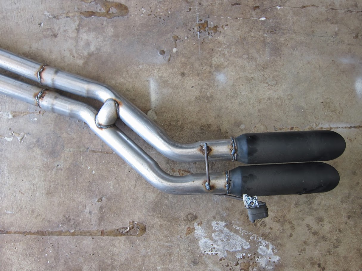

I dropped my exhaust to inspect the guibo on my output shaft and I snapped a couple pics that better show the configuration of my exhaust system along with the custom H-pipe muffler delete.
Current setup is the same as listed in the OP and I have not had a chance to install my longer vibrant resonators ...soon.

So you have a H-pipe bridge like mine (and Berk)? Got any pics?
$100 is a good price, and when you say mandrel bent do you mean a bunch of pieces welded together (different elbows and such) or is it a continues piece of pipe?

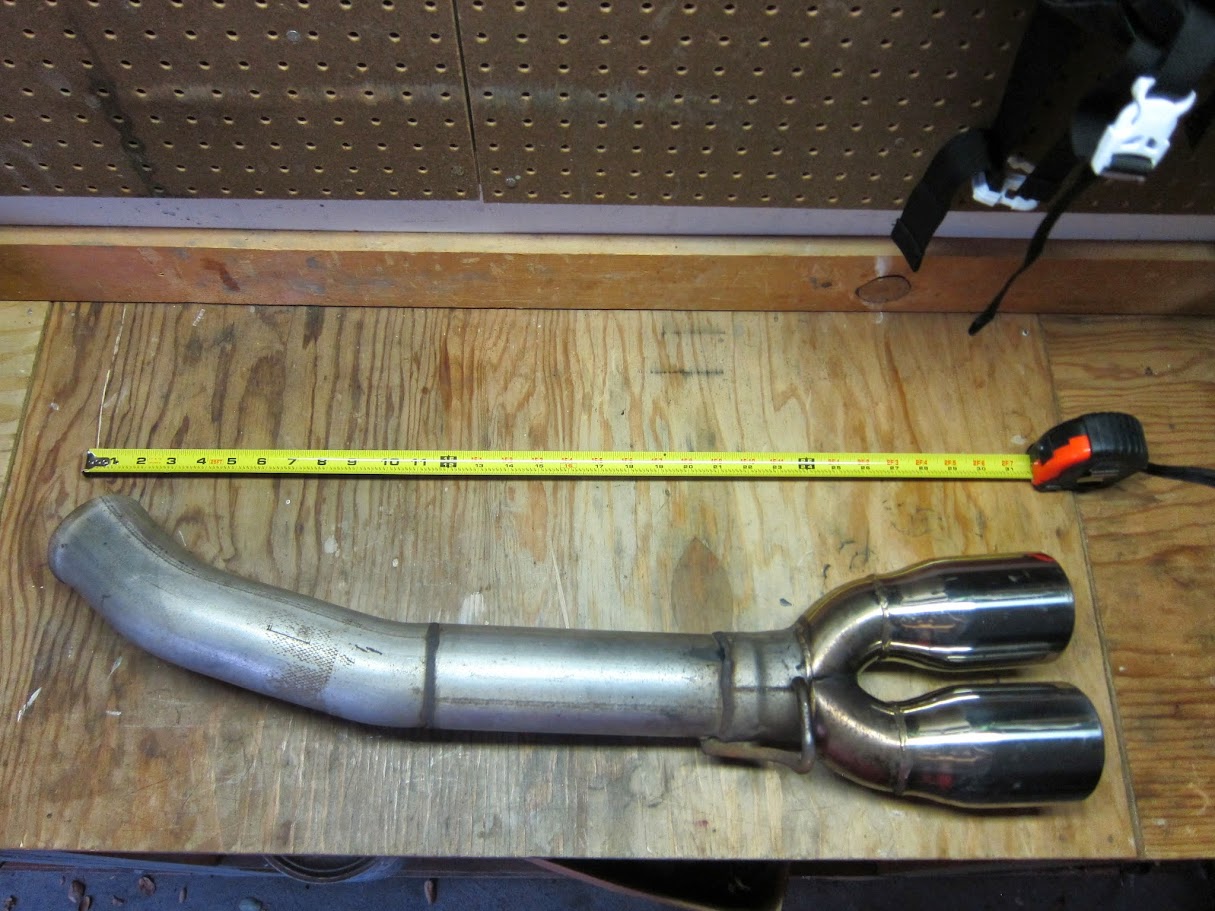

I paid about $165 for my previous muffler delete and I supplied the tips, see below.
