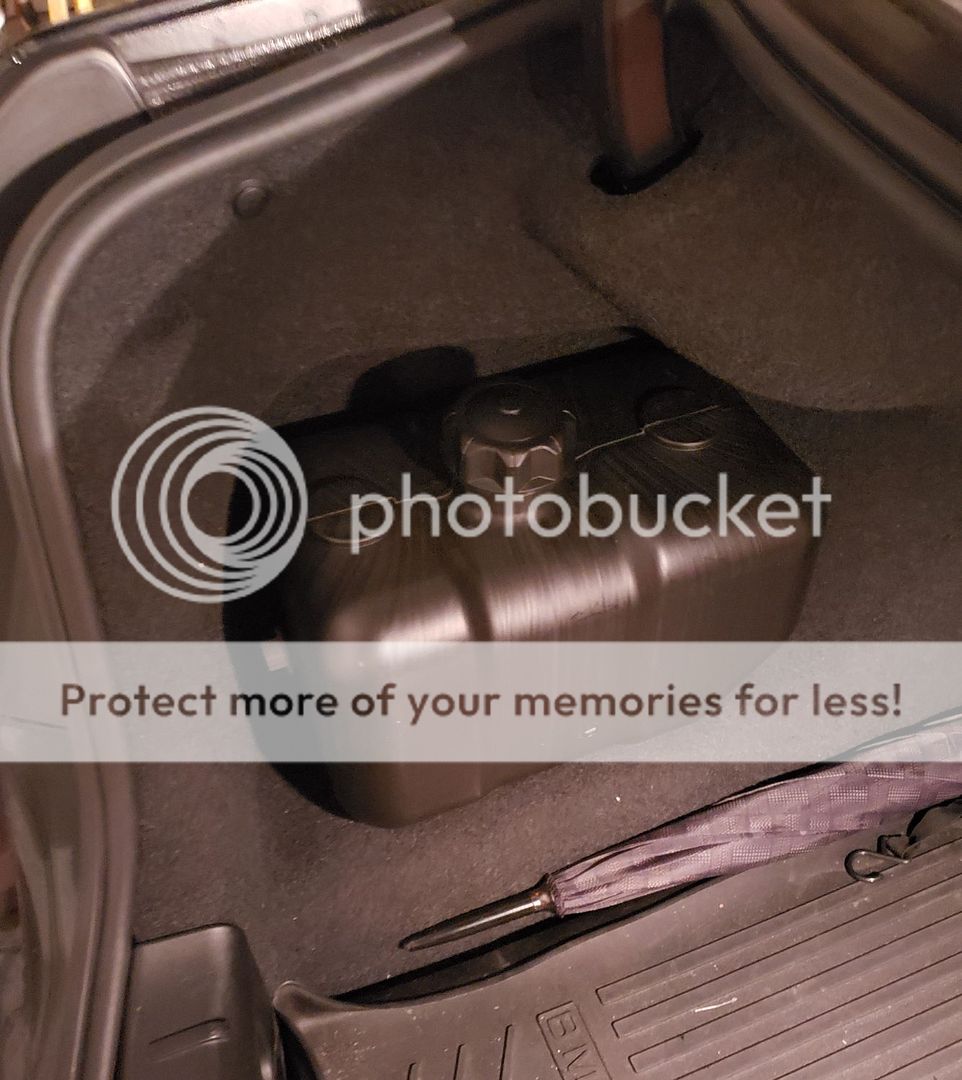

So I ordered a Banks 2.5 gal tank from summit and it arrived. Fits the area in the trunk I wanted but I will have to come up with a decent attachment method as the metal straps it came with won't work.
Perhaps in November I will get some time off to actually work on the car now that I have the components I need...[IMG][/IMG]
