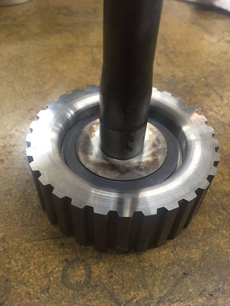

Hey guys i am from Australia and heavily involved in the hardware side of the upgrades for these transmissions with Nizpro.
Here are a few shots of the billet input and intermediate shafts Nizpro has ready for the HP19/21.
I will post some more info tonite and show some differences between these and our HP26 stuff and many of the weaknesses that have been identified in the HP19.
Input shafts
Back of input shaft with custom bronze bush
Intermedite shaft with upgraded billet basket

Will you also be making the billet pan for the HP19 too?
