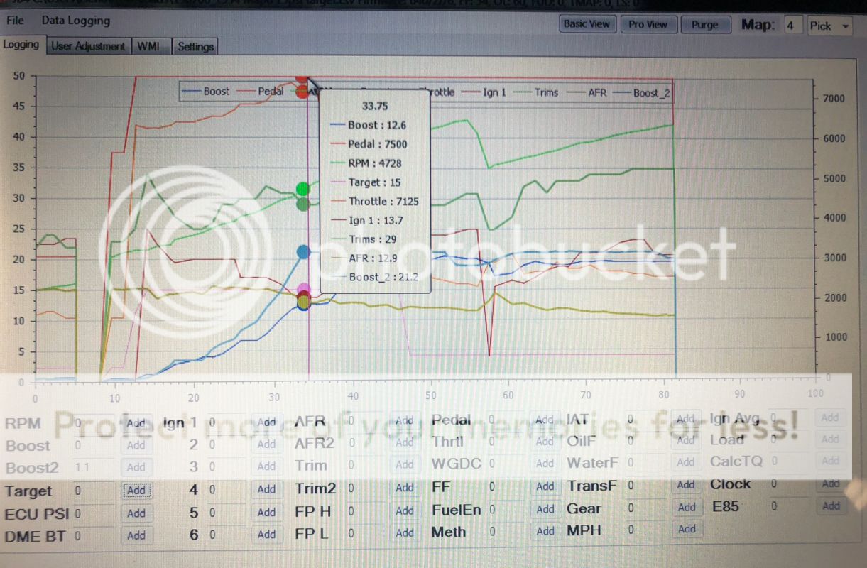

Hey Terry i got new V2 JB4 and seems like something not right when comparing Map0 and map4, arent they both suppose to be stock flash boost target?
When i did Map6 with target 15psi boost went over 21psi on bank2 while boost bank1 around 16.5psi

Just need the CSV files, not photos.
When you switch to a safety map throttle will close so the boost reading will be falsely high. Big issue here is bank2 boost is off the scale. Even your map0 is over boosting a bit. I'd start by disabling WG control all together by setting FF = 0 and logging map1.

Here is Map1 with WG disable and FF = 0
Seems like Boost2 is overboosting over 21.2psi & it kicking into Map4

Something going on with Boost2, on second log I did from 4th gear and it went in to Map4, look how close boost1 to boost2 after it shifts in to 5th gear(Map4)

Still over the target. My external digital boost gauge showing no more than 12-14psi, could be a Map sensors calibration off on jb4 firmware?
