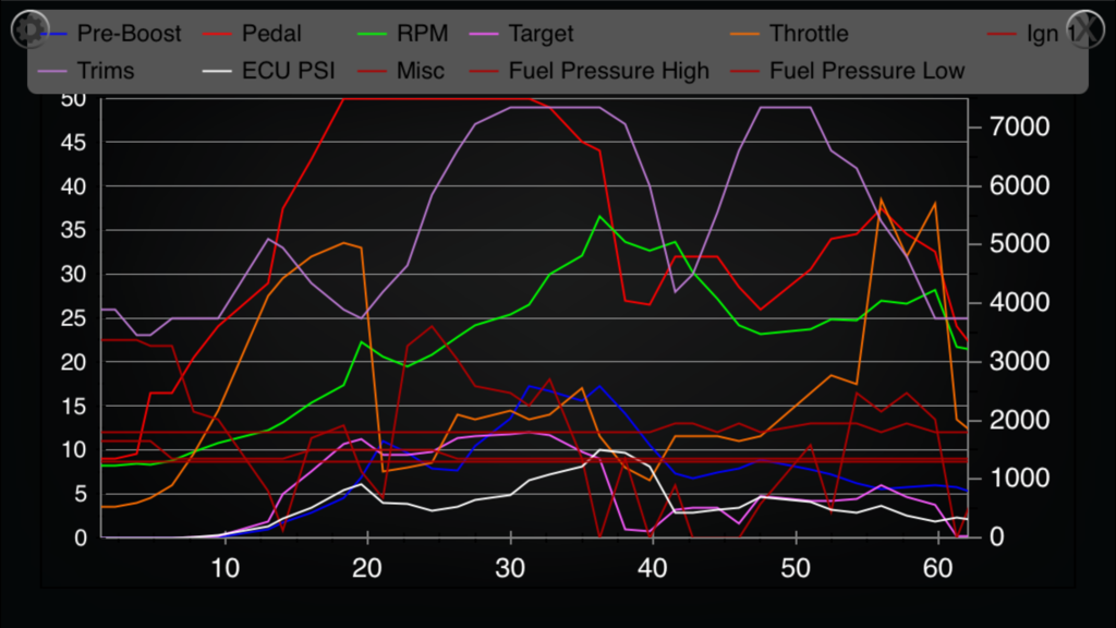

I will attach a jb4 log from this morning. This is the best log I can get as the car wonít take much WOT. I will also try to attach the csv file if I can

For starters trims are maxing out. It's also much easier to read and diagnose logs taken in 3 gear as they are a little longer and wheel spin/DME intervention isn't as much of an issue. Currently you are running lean, overboosting, and so on.
Put FOL to 90, FF to 60, and try a 3rd gear log. I'm assuming the diode is cut on the JB4 correct?

UPDATED 3RD GEAR LOG WITH REQUESTED CHANGES TO SETTINGS

Any misfires? I don't see anything unusual in the log.
