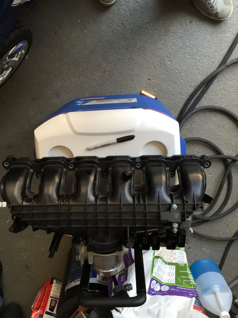

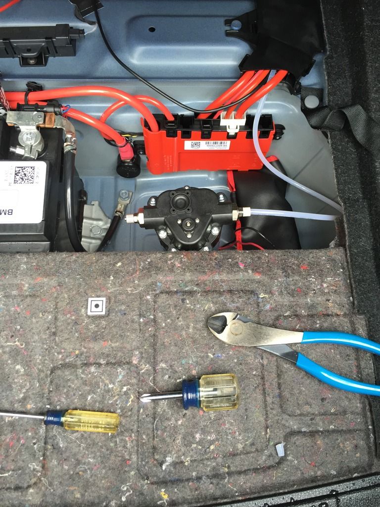

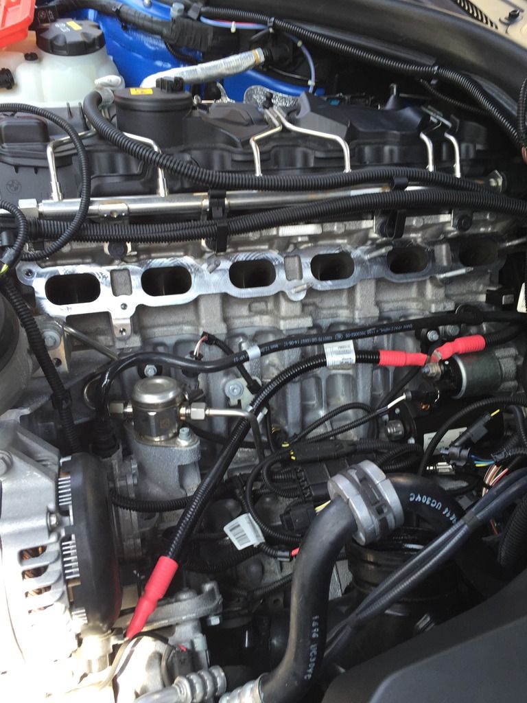

Just wanted to post up some pics and get some feedback of the install. I am still waiting on a 2.3 gallon trunk mount tank that I bought from coolingmist. As soon as it gets here I'll be up and running!!! Gonna run 7 jets, possibly 8 if I have too. (6) .4mm check valve jets for each intake runner and (1) .6mm check valve jet in the ER charge pipe. I may add another in the charge pipe if necessary but I doubt I will have too. Maybe when I get the stage 2 pure turbo down the line.....
Also a fyi, I have been working with Richard from Aquamist on integrating the hfs-4 failsafe into the electronic wastegate. It is not necessary since the jb4 will handle no or low flow situations way better than the Aquamist failsafe can but I am still going to integrate it for high flow situations. Anyway it will be an additional controller that will integrate into the grey wiring harness.

What are the benefits of running 7-8 jets vs just 1-2 jets in the charge pipe?
Even distribution would be a benefit to having a jet in each intake runner.
By running it this way I can put a smaller jet in the charge pipe just really to cool iats, then evenly distribute a ton of meth to each cylinder. I could effectively run way more meth this way if needed since fueling is so limited and I really want a big turbo.
Plus this is very effective at keeping intake valves pretty clean on a direct injection car. I saw this on my last build, intake valves were really clean.
