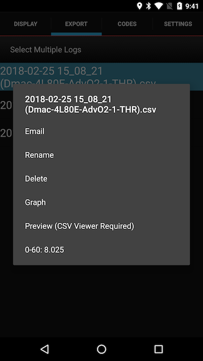

So we do have to 0-60mph time feature and 1/4 miles as well with this jb4 connect kit correct? Reason being is that I see the 0-60mph under speed timing in settings...but it doesn't work when I start a log. Saw a video somewhere of someone having a 1/4 mile feature but probably a different version? I have rev3
iOS or Android?
IOS
A version is enabled on the iOS version, but not Android.
I'm in the middle of adding functionality that will calculate 0-60 from JB4 logs (for engine types that support the speed output). 1/4 will be going away permanently (for iOS and Android) as that relies on the phone's GPS which has a terrible refresh rate of 1hz and is not that accurate.
