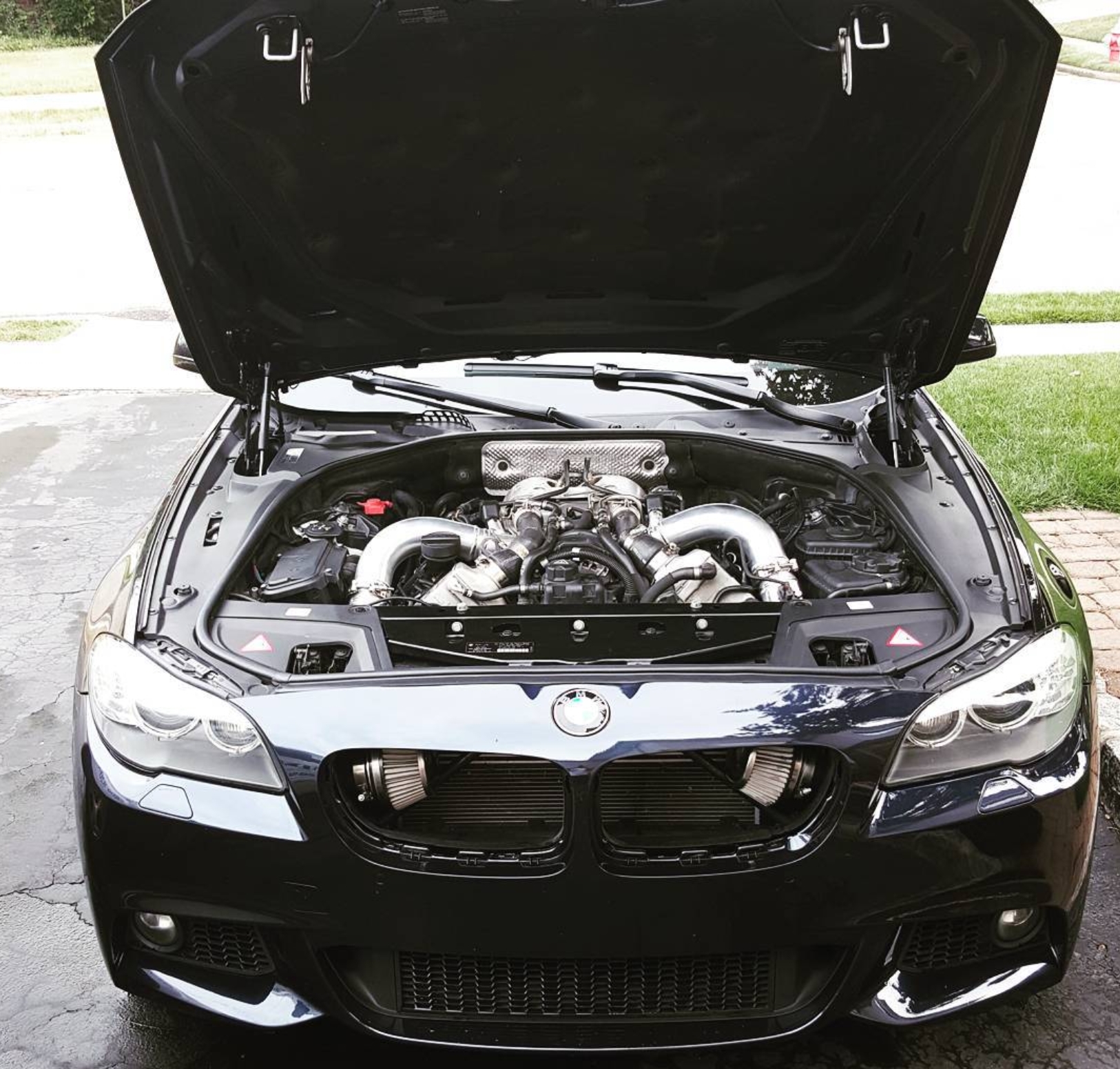

badblack550ix's Avatar
badblack550ix badblack550ix is offline
Posts: 269
Join Date: Jun 2013
Car: F10 550i Xdrive
Default 11-28-2017, 10:36 PM
Originally Posted by Mike_L
So 600/635 wheel. Whats the M5 making?
BTW those intakes look way better than the maze of ***** from N63intakes. Maybe a set of Pures and *** next?
Maze of **** ? i did this set up in 2015 no one wanted to remove the cross bars and intake like this was not performing well. That's why so called maze of **** was the only way to go.
F10 550i xdrive Carbon Black Aluminum BMS Stage 2 WR 11.943 @117.940 Time Slip 421AWHP 467.9 AWTQ MUSTANG DYNO
(#131)
535_BiTurbo 535_BiTurbo is offline
Posts: 300
Join Date: Jun 2013
Car: 2010 535
Default 12-01-2017, 02:35 AM
Not performing well?? . what do you mean?
