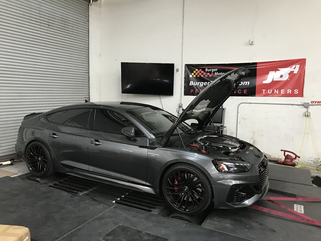

We had a RS5 come in for some JB4 testing on our dyno. Car is fitted with Wagner Charge cooler kit which should not really be relevant on single pulls with cool down period. Due to heat compensation from ambient temps the car made quite a bit more power stock as the ECU adjusts boost up to compensate for high IAT. Tests where done at 95F. Goal of the tests was to evaluate if any of the ready maps need revisions which they don't. Regardless we managed to crack the 500whp mark on a E35 mix on map 6 and just short of 500whp on map 5.
