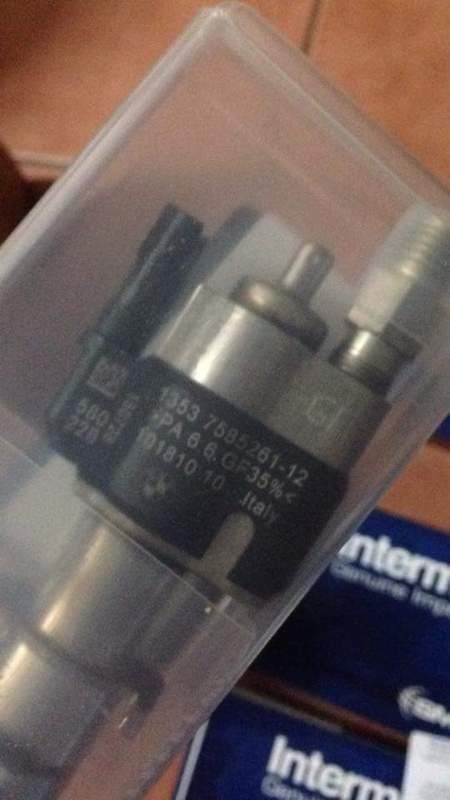

I ordered 6 FJ1050s a few weeks ago and recieved 6 index -12 injectors with BMW roundels. They appeared new, with covers on the fuel fittings and over the seals.
I've only had them in for about 500 miles now but they run perfect. I had a slightly rough idle, and what seemed like a dead cylinder or two on cold starts. Runs great now.

I to ordered 6 new ones from rockauto.
Specifically mailed them for index 12 injectors, just to be sure.
And they delivered. 6 brand new index 12 injectors with bmw logos.

Some people have reported receiving non-Index 12's from RockAuto. I searched through my emails and found an exchange I had with their customer service rep regarding sending Index 12's.
Luckily all of the ones I received were brand new Index 12's. They also came with new couplers and o-rings.

I got them from rockauto too, all index 12, with extra o-ring and decoupling element.
installed, they worked fine so far (500km on them)
