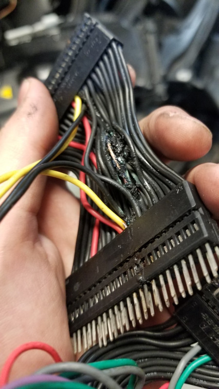

I replaced my engine recently and these are the two codes I'm getting. Previously had JB4 installed, had some wiring issues that ended up frying the harness so I removed JB4. Removed the Back End Flash. During the engine swap I replaced the turbos with some from a member here with 8k miles, put on new silicone lines as well & set the wastegate arms with a Mityvac at 5.9hg of vacuum.

Flashed back to the latest stock IJE0S map via MHD yesterday. Previously it was JB4 Back End Flash paired with JB4. JB4 harness got fried as soon as I connected the battery for the first time after the engine swap. It was either my fault or the previous owners fault I'm not sure. Ghetto wiring/splice was added to one of the MAP sensor wires for a Fuel It! Throttle Body Injection (ground wire?). Had the codes while still on the BEF, so I flashed to MHD Stage 2+. It was only a 2-3 minute map write and not a full overwrite so that's why I flashed back to stock. I wanted a full map write but it didn't seem to work.
