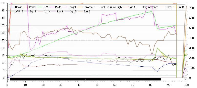

I recently switch to e85 blend of 5 gal per full tank and the car ran better than ever up until I uploaded to the most recent firmware. Now it has a huge lack of power compared to before and can't boost over 14 psi. I will post logs later today or tomorrow when the rain stops. What map and rpm range would be best for logging?
Mods- jb4 g5 iso (latest firmware), bms race backend via mhd, hexon rr500 turbos, vrsf 3" dp, vrsf 7" fmic, dci, dual 10cm meth 50/50, ER charge pipe

Log whatever the issue is. Normally a run from 2k to redline and a 3-4 shift.

Default 10-10-2015, 01:46 PM
this is in map 2 3rd gear starting about 1800 rpm to redline

Default 10-10-2015, 01:53 PM
Would need csv file not a photo.

Looks like a WG vacuum line issue to me, do the vacuum line test shown in the support forum.
Thanks for the info terry, turns out i had a vacuum line that was pinched now with that fixed iv got a whole new issue while wot being put into map4. heres a log. Thank you!
BTW when i started the car for the first time after fixing the vacuum line i got a cc-id 29 code. restarted the car and no code

  1. It looks like you got a Map 4 Switch due to overboosting early on, likely due to your FF being almost maxed out at 150. This forces the JB4 to send too strong of a WGDC signal to the DME, so the Throttle is closing to compensate. Change it to 100 for now, it will learn up or down later on. Also change your 'Boost Failsafe PSI' to at least 20, instead of 18.
  2. Even though it switched to Map 4, your Boost Target is still very high. That does not make sense to me. Someone else should be able to figure that out for you, but not me.
  3. Later on in the pull, you ran out of Low Pressure, then subsequently High Pressure, Fuel Pressures. This is too much E85 for that boost level. Try sticking to Map 1 for a while then post logs.

1. You need to set mode 4/2 if using a back end flash map.
2. You need to upgrade your low pressure pump. If you have Stage2, get Stage3. Turn down boost until you do.
3. Codes are read via the JB4 interface settings tab. cc-id 29 is not a fault code.
4. FF is way too high, probably from racing around, with the vacuum line issue. Lower it to say 100 so it can readapt up or down.
5. Enable 6-cyl logging mode.
Beat you to it Terry
The 4/2 setting was what I forgot. That's why the Map 4 switch did not lower your Boost Target.
