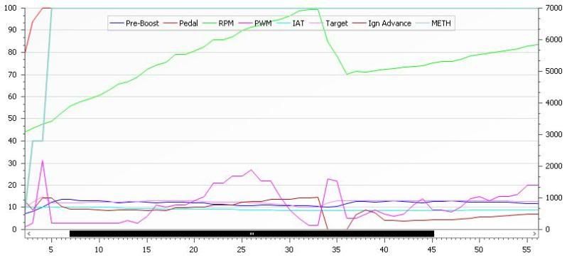

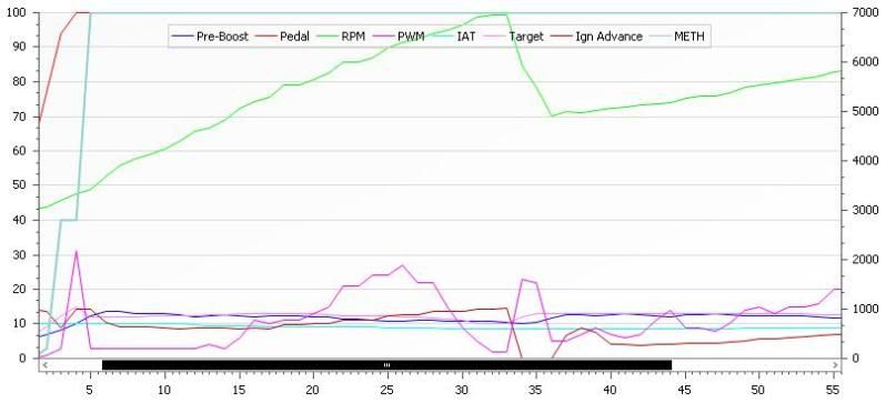

Hey T, I seem to be having the same problem as another user in another post. Posting here as others may end up with the same issue. I have the system X and my understanding is that all I have to do is wire it up and I'm set. Nothing to change on the CMGS itself. Unfortunately, meth flow shoots straight up to 100+ on the log. I have one of the first alpha batch boards and installed a 20k resistor inline. CMGS set for 8min and 13max. It's only running 11-12psi boost with a 4 adder. Any suggestions?
(#82)
Posts: 33,334
Default 06-05-2011, 04:36 PM
Perfect! With 1.10 100 means you're at maximum flow and everything is working properly.

Well that sounds great! However, it doesn't seem to be adding boost over base on map 3...I just sent you an email with a couple logs.
Can you post them somewhere?
Here you go.
You need the alpha firmware for that. I'll clear through the email tomorrow and send it over.
