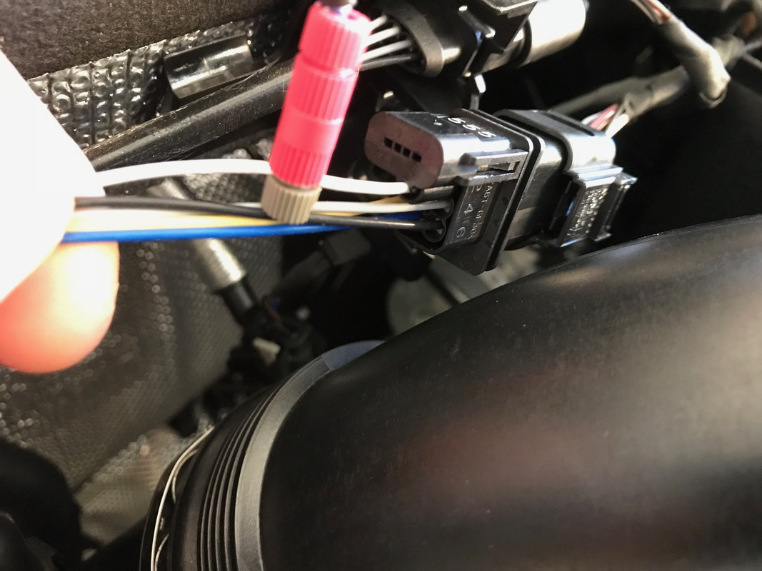

Default 06-22-2018, 06:20 AM
Can one of you guys please shoot me over a picture of the positap connected to the white wire for our install instructions. George@burgertuning.com .
2017 Audi 8V RS3 Sedan
2018 Polo GTI
Posts: 319
Default 06-24-2018, 08:29 AM
Got quite a few pictures sent by guys which is appreciated but noticed some guys have MK7.5's but no PP cars that have the old type O2 sensor with the grey plugs and five wires. On those you connect on the red.
For Mk7.5 PP 245 and Skoda vRS245 connect as per the below:
