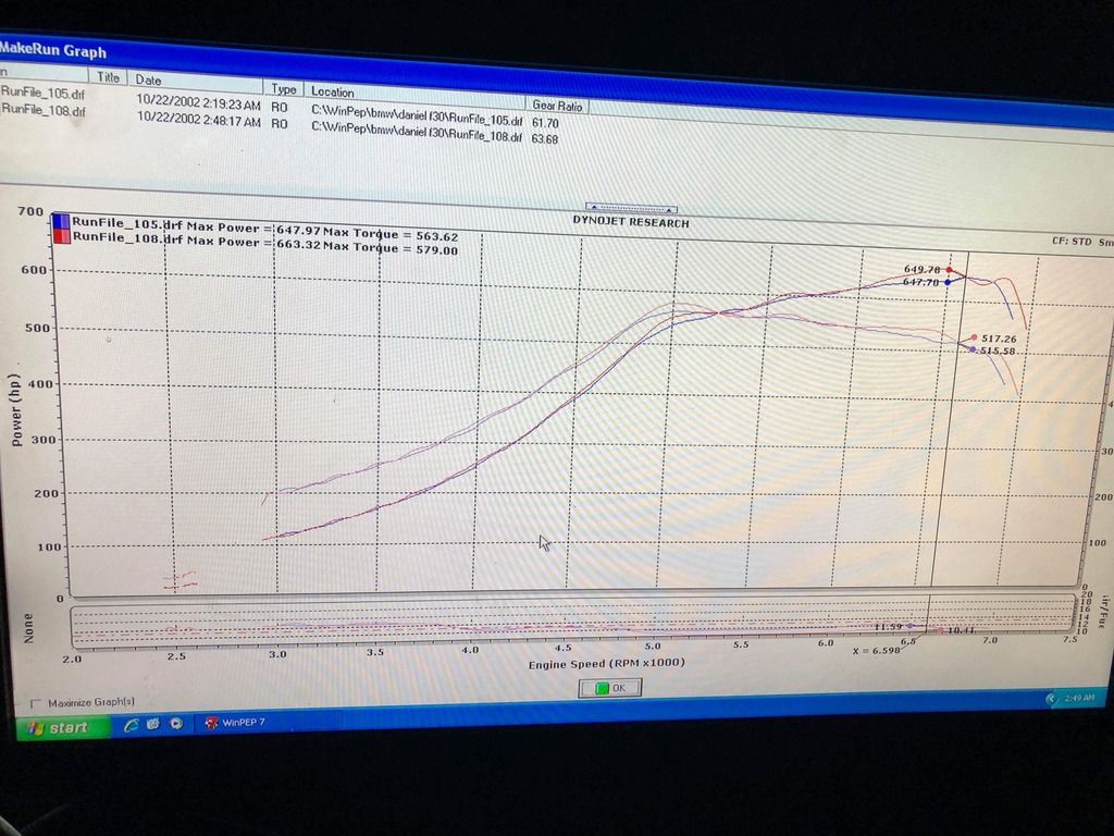

So we been working for a couple months on Dan Foley’s 2013 f30 n55 first one with a docrace top mount (on production) at first we were running the jb4 on top of a ess flash that the car had,we were able to get 626whp couple months ago but we started to have some boost drops issues and a couple other problems, well we talk to mhd and got a beta testing spot, contacted terry to work on a BEF ,we been login and working on it for a couple days after getting solid logs and boost on point we decided today to drop it on the dyno and this are the results for now. The first pull was @28psi and the second one was @30psi we still have a little more work to do but decided to keep it here for now huge thanks to terry@burger for the help, and to Dan for trusting us with his vehicle.[IMG][/IMG]

Looking really good!! This is some serious power on an N55. Full e85 correct?

Looking good maybe some tuning would pull up the spool. Will be nice to compare the different n55 options in a few months
thanks,yes full e85

100 whp and 200 wtq at 3K rpm?
That car would get crushed stoplight-to-stoplight by a non-FBO car running a JB4 only.
Not worth the $5K+ investment, IMO.
Those funds would be better spent on a Stage 3 bottom-mount.

True it's always a trade off with big turbos. It might not win a 0-60mph race but in a 0-150mph race would put a few bus lengths on a stock turbo car.
I understand the trade-off in going to a bigger turbo, but ideally you're looking for that to be somewhat of a balancing act.
Overlay that dyno against a PS2 or Stage 3 bottom-mount; this kit misses it by a mile.
Same peak power as a Stage 3, but only available in a much smaller rpm range.
if u want fast spool, go for speedtech, their efr8374 kit put same numbers as the single scroll manifold 6266, but spool about 1000 rpm faster.
i don't know why docrace don't offer a twin scroll manifold for n55

It's not about just "spool".
Look at the total amount of area under the curve.
This set-up takes a long time to start moving air.
the dyno sheet reminds me of the pt 6870 spool!
I would not go strictly by the dyno you have to drive this car to see,I think it will destroy a pure stg 2 upstairs. The pure stg 2 makes nowhere as much power higher rpm's where this does and this also depends on what gear this car is being dynoed in.
Would love to compare my PS2 setup to one like this. race from multiple speeds at a 1/2 mile event to get some comparison videos to post up. I know thereís a few out there now just a matter of time I guess we could always compare vbox/draggy results, I donít think Iíve seen any n55 post verified results faster then peters old PS2 euro 135i. IIRC 7.4 corrected to 0% slope. He would have to confirm that though
Unless this car has a 4500 rpm stall converter, the only chance it has against a PS2 is on an airstrip (or an even longer distance straight-line event).
0-60, 1/4 mile, Auto-X, and stoplight-to-stoplight, a PS2 would walk away from this car.
A Stage 3 bottom mount wouldn't have to worry with this car, even on an airstrip.
