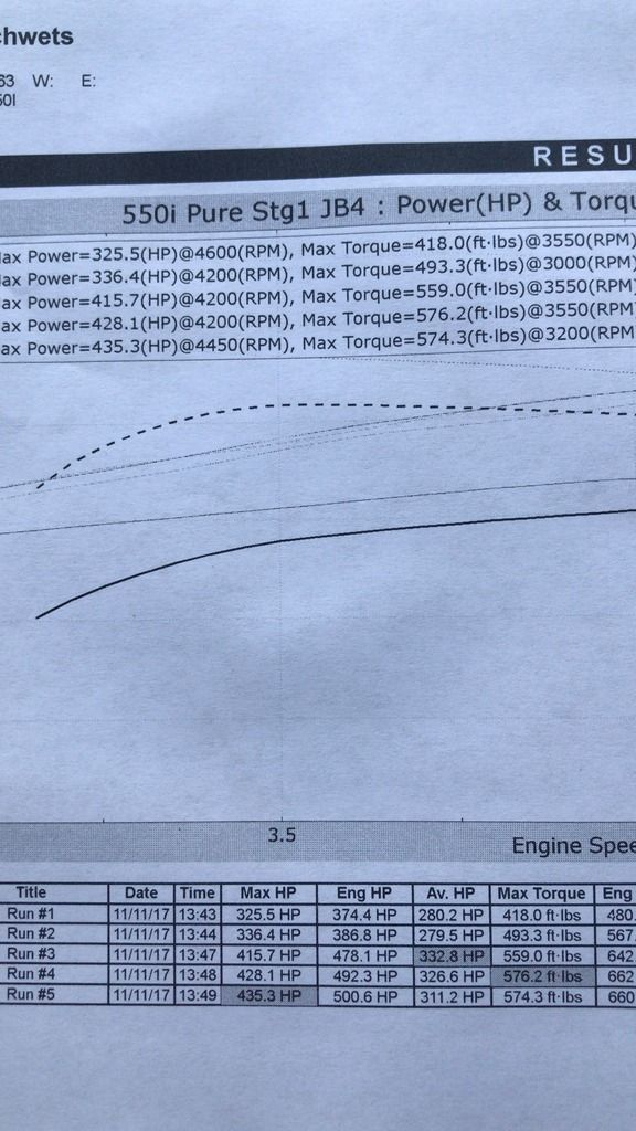

Here's a log on each map with dyno sheet to go with. Let me know if you want/need anything else. Stock '11 550i Pure stage 1 turbos & JB4

Posts: 31,917
Default 11-15-2017, 09:38 PM
Huge bank to bank boost variance. One bank is stock boost, the other much higher. So some physical issue to be sorted here.

Fr0z3N Fr0z3N is offline
Join Date: Jun 2013
Default 11-15-2017, 09:45 PM
Could it be a bad diverter valve?
